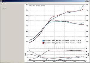

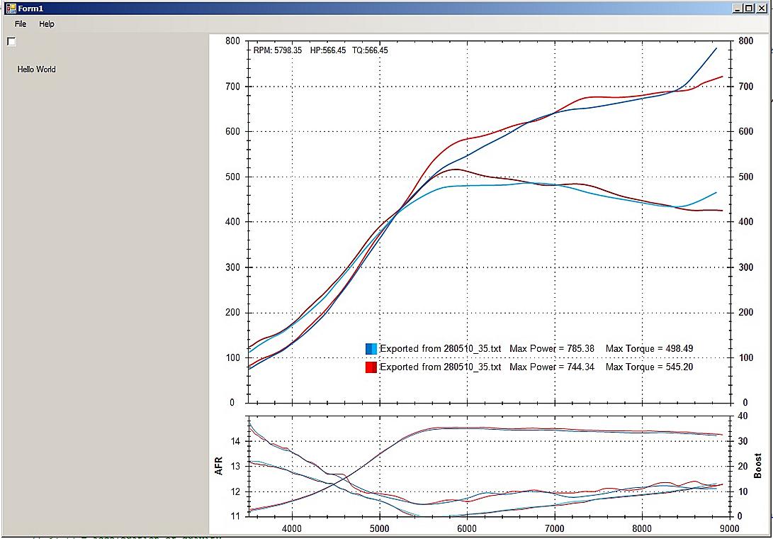

TheBoz's Avatar
Joined: Jan 2005
Posts: 1,279
Likes: 15
From: Space time
THis app is very cool.
I did a little reflector work over the weekend, and decided to tweak a little on my own.
If you could get your graphs to look like this you would be set.
I also added a Dyno Jet style HP/Torq Status with the Color codes, Boost pressure and Timing added to the lower AFR Graph, and synced the graphs so that the alignement marks for RPM are the same. Also added a Status message that shows you the values of the X/Y cord.
Let me know if you need some C# help.
Attached Thumbnails Virtual Dyno - Standalone Software-myversion-virtualdyno.jpg
Old Jul 6, 2010 | 02:59 PM
  #225
Evoryder's Avatar
iTrader: (55)
Posts: 7,383
Likes: 10
From: ☼ Florida ☼
