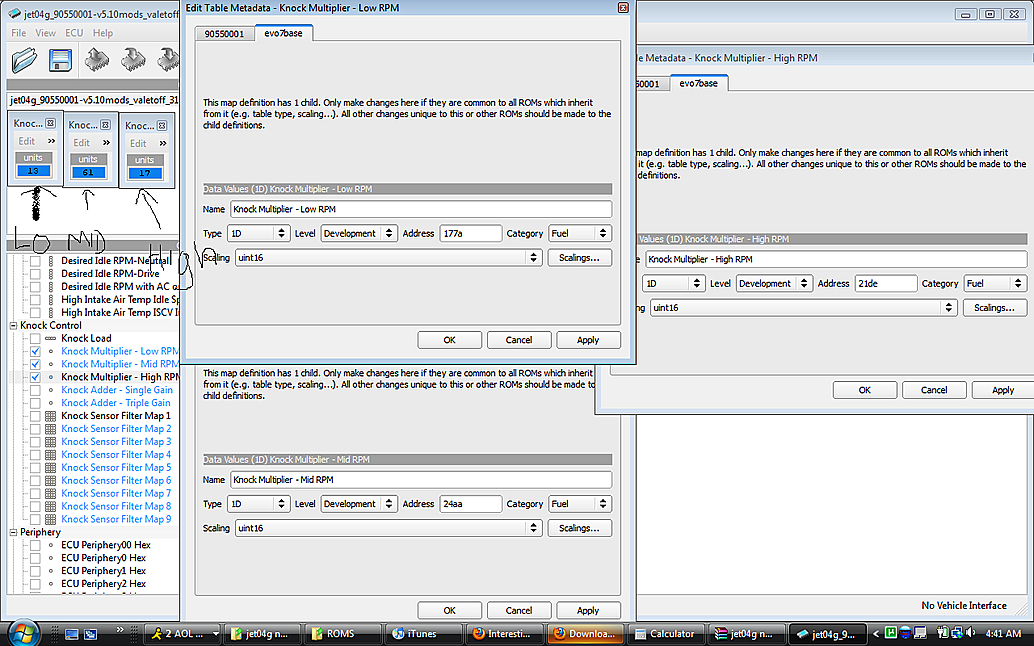

Knock control
-knock multiplier ( low mid and high)
whats intresting is that the rom you have the knock low is the same as the evo 8 and the mid is realy realy high, and the high is 2 less i dont why mid is so high on the evo 7? maybe some one can answer that.

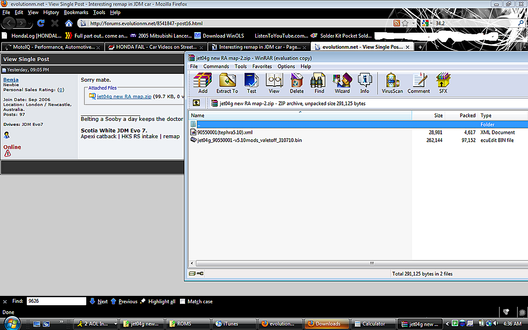

hes running 90550001 ... v5.1 ... he posted up the rom and the xml......

I'm sorry which post is the xml in? I just downloaded all of them and its not there.

lol dnt be sorry its 4am in the morning lol. ur probably squinting @ teh screen like i am lol
https://www.evolutionm.net/forums/8541847-post16.html

Hmmm...I can't see this knock control stuff on my XML i've been editing it with.
The rom and XML is the one I downloaded off geekmapped.com to get me up adn running semi safely.
Should I just start again with a fresh Evo 8 Rom and V7?
it should be in you evo7 base....

Yours must be referencing another XML dude, a more complete one.
I just deleted all XML's related to 90550001 and downloaded mine from the link on page 2 and still can't see the stuff you do.
