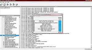

Originally Posted by grayw
You need to use the same Tephra version of 90550001, to enable launch control.
I have that version but the launch maps seems not to be there
Attached Thumbnails How to setup my 2step/ launch control-tephra.jpg
Old Sep 19, 2010 | 06:12 AM
grayw's Avatar
Joined: Jan 2007
Posts: 198
From: UK
No separate launch ignition/fuel for launch control in V5.1, just a working stationary rev limiter. You will have to wait for V7 for 90550001 if you want to make adjustments to stationary ignition etc.
