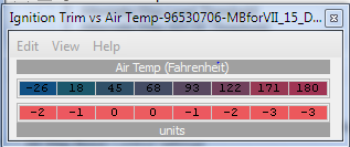

My suspicion on the bad gas was correct. Last week, I refilled my car with a tank from RaceTrac and retuned the car. Look at the difference:
Attached Thumbnails Dumb Question Knock issues in cold weather no increase in load-evoscandatalog_2010.12.14_22.27.01vscrapgas.jpg

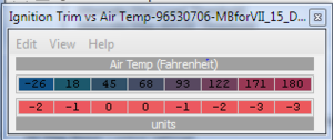

Originally Posted by tscompusa
timing wont ever change with weather, just afr,
There are some temperature compensation tables for ignition in the tephra ROMs, just they usually go negative with temp.
Attached Thumbnails Dumb Question Knock issues in cold weather no increase in load-temp-trim.png
