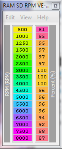

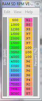

I'll try to take a look at my tuning laptop tomorrow if I get a chance. I haven't touched it for months. I'm looking through what I have on this computer, and this is what I found. I don't know if this was my final tune or not.
When I was on SD, though, the tune was pretty much spot on and I really didn't have any issues. I matched my MAF load to SD load as well as I could and used Excel to make a 3D VE map out of the two VE tables and went from there.
I'm not on SD now, though. I didn't like the heat soaked MAT sensor issue on warm start and didn't want to band-aid fix it. And since I just moved to CA, I had to sell my Amsoil filter and Dejon intake anyway and put back on the stock box. So, since I was putting a few things back to stock, I figured, until a patch can be made to handle the heat soak issue, I'll stay on MAF for now.

I played with it some more today. I set my entire open loop section to 14.7 target AFR... then started playing with the RPM VE and MAP VE. Mine turned out looking different than yours by a bit, but I think it works well.
Idle is much better, cruise is better, tip in, and tip out is better... it pretty much does what I want. The interesting part about looking at other people's maps... the lowest RPMS are affected by their latency calcs as well as their injector scaling... the higher RPMs and loads can vary based on people's preference for AFR.
Thank you guys for the help. Its coming along nicely now
