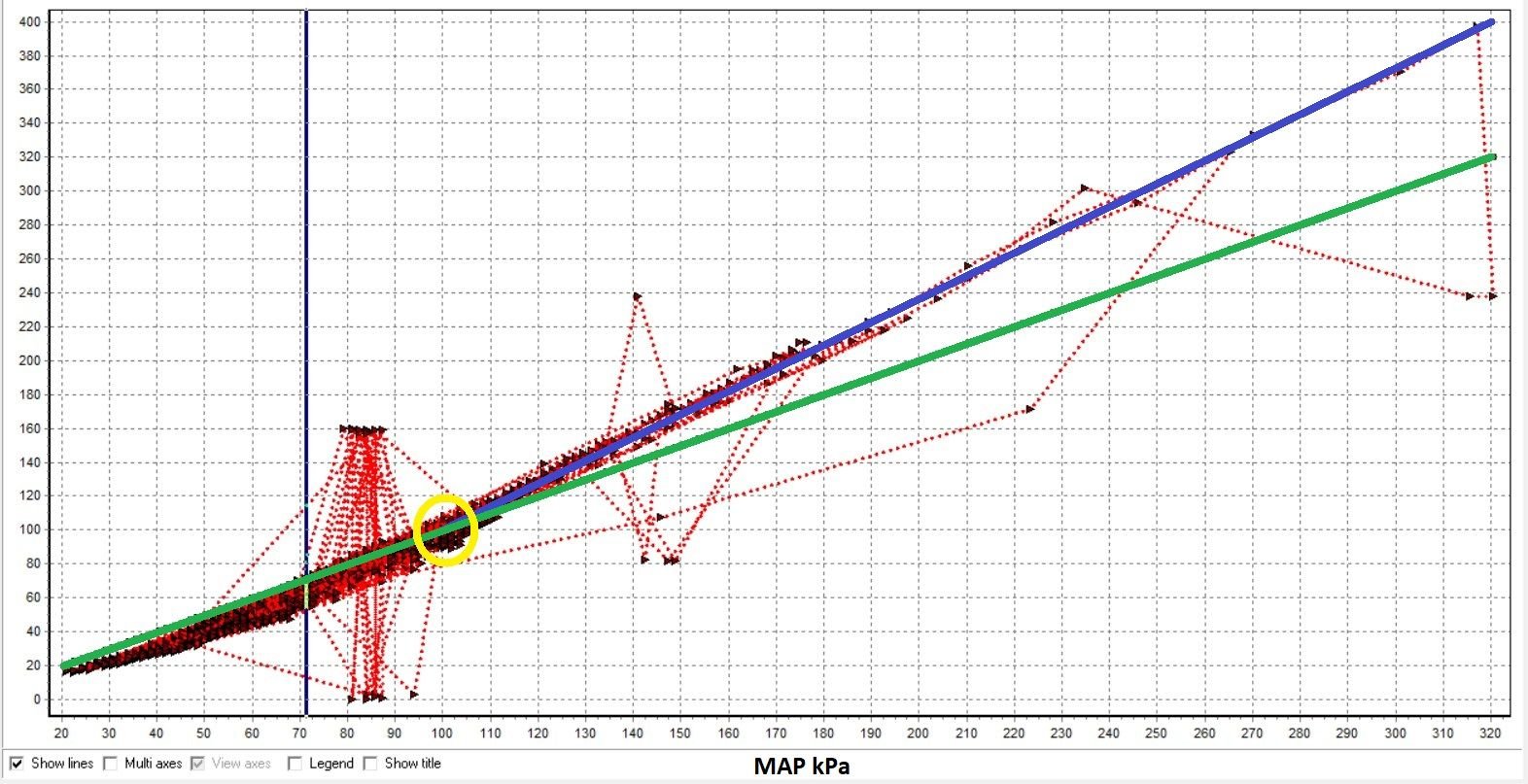

I have my load to kpa 1:1, but in my logs 100kpa is showing around 65load causing me to run lean. Is this normal? I have 1000cc injectors and hks 272 cams. I can use maf scaling to correct it, but shouldn't it be closer to 1:1?
also changes to ve does not do much at higher loads 100+
Load to kpa will be 1:1 up to about 100kpa, but beyond that it will diverge. To understand how to define that table properly you need to log boost (kpa) and Load and then graph boost (kpa) as a function of Load, which I show below and this then gives you the correlation. Remember, you must log the Load value that corresponds to the load value used in your ignition, MIVEC, and fuel table (not VE table). What this table does, as best I can tell, is applies the VE correction to the correct LOAD in your Fuel Maps. Therefore, the VE table is the only table that actually references boost (kpa) whereas all the other tables reference the calculated load. I explain it all here....
https://www.evolutionm.net/forums/ec...onversion.html
If you look below as an example, the Load:kpa ratio is 400:320. Therefore, when load is 400 I have 320kpa of boost.
Great information. I also discovered that for some reason the folder where ECU flash is stored, is set to read only and when I make changes like set the proper scaling for my map sensor, it's not saved and goes back to the 4 bar map sensor every time I reopen ECU flash.
