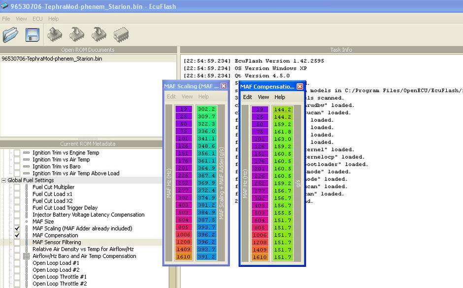

try this.
Attached Thumbnails help,  TephraV7 rom scaled for Evo3 ?-tephra-v7-e2-maf.jpg

seems it's different
in my rom there arent such tables as MAF scaling and MAF smoothing
only maf scaling together with adder, with the values uknown for me
if yu don't want to upload your rom here, maby you can send it on e-mail ? it would help me much
Ignore his left hand side its just not scaled he's got it set to unit16 instead of mafHZ scaling.
The smoothing table is the compensation table same address and everything just named differently in some roms consider them equivalent. Looks like the scaling on the right hand side for both of you is airflow 8 on the compensation/smoothing table so you should be able to copy his table over.
The scaling table right hand side needs to be set to airflow 8 on your side if you plan on using his settings or it wont work right.
there is nothing wrong with the left hand side.just because its not in Hz does not mean it does not work.also reason its not in Hz is because its not in the XML and iv not bothered to add it.
You misunderstand i don't want stunt 2 copying over the left hand side. If he does it wont work right.
