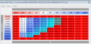

CDrinkH2O's Avatar
Joined: Nov 2006
Posts: 1,147
Likes: 162
From: San Francisco
fireroasted
Check this out: http://www.swri.org/3pubs/ttoday/Sum...n-and-Cool.pdf
Then look at the stock EGR duty table. 50-80 load at 3000 rpm is where most of the action is at highway cruising speeds. EGR duty is 100% at that point in the map, probably to help stop the knock that would be induced by the more advanced timing.
If you deleted your EGR you won't have its anti-knock effect so you must also either zero out the EGR advance table or turn it off completely with Mr Fred's EGR System Enable/Disable patch.

Interesting read, and different from what I had learned. Thanks. I do have the EGR delete and the MrFred disable of the system. I am still chasing this though, so I will add zeroing out this table and doing a before and after to see if I can log any variances even though it shouldn't impact anything (because of the disable).
