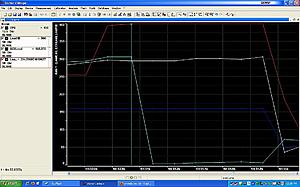

So i set out tonight to try and solve an issue i'm having, but ive failed

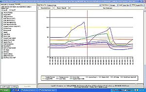

Under WOT, my load number seems to be resetting.....here is a screen shoot of what im talking about.
I stay at 100% TPS, but when load hits ~130% mark, it drops to ~12% and starts to climb......this causes the AFR to go massively lean half way through a pull.
any ideas?
thanks!

If it was actually going lean due to that, I'd expect IPW to drop as well, and it is not. Also the timing should drastically increase and knock would be through the roof. What are the values you have setup for 1byte? IE, the multiplier, 1.2, 1.3, etc. Is it set the same in evoscan?
There is too many other lines in the lower half of the graph to see much else...try not displaying so much stuff and focus on the few that you need right this second.

id was looking for the same thing, I thought the IPW should drop while advance should sky rocket. Thats why i'm so stuck on this point. I'm going out to play with it rite now. I just set the multiplier to 1.8, it was 1.4

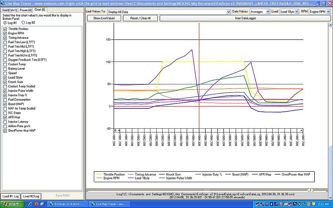

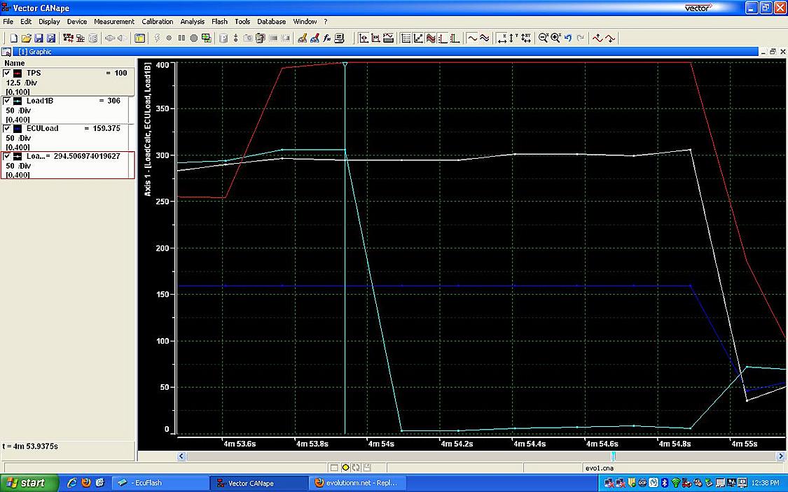

i set the load conversion to 2.0 yesterday in both EVOScan and the tune file. here is a better picture of everything falling while still under WOT.

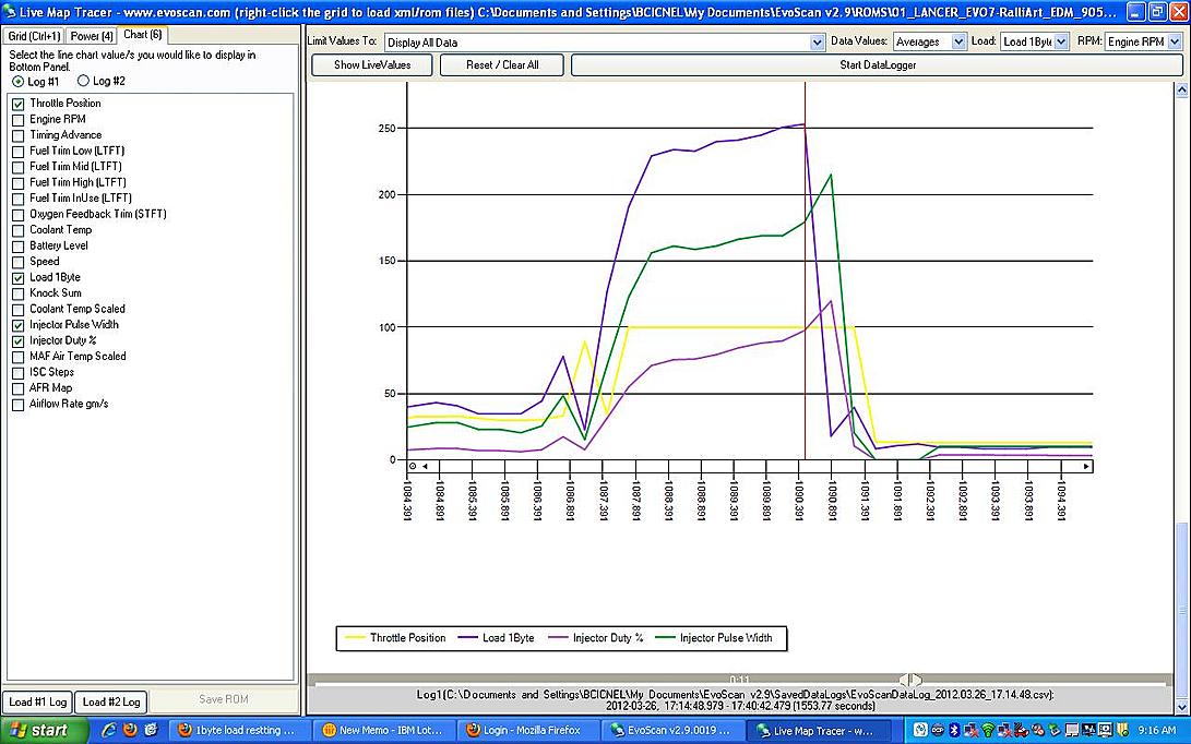

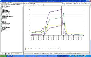

happening on a different car.
Attached Thumbnails 1byte load restting under WOT?-1.jpg   1byte load restting under WOT?-2.jpg
