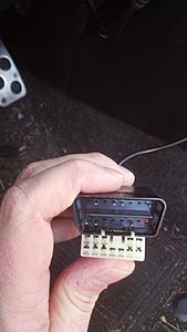

I need some help with Ecuflash. I am new to stock ecu stuff and I can’t get my laptop to connect for the life of me.
I have tried the newest version as well as 1.29a
I left the car on a charger all night
EVOlutionary brought his laptop over that he uses on his evo 9
I uninstalled and reinstalled the drivers
I tried Ecu unlocker
Did I miss anything?
Attached Thumbnails Help connecting with Ecuflash-photo-1-1-.jpg   Help connecting with Ecuflash-photo-2-1-.jpg   Help connecting with Ecuflash-photo-1-.jpg

It also seems as though you're missing a pin. In the pic you have 6, I just went out to me car and mine has 7 pins in it.

I think it is the wrong cable, I'll snap a pic of mine tonight and post it. Like I said before, you're missing a pin on the odbII plug and it looks as if there are 3 wires into the back of the reflash cable, there should only be one.

my tactrix openport 1.3 cable only has 5 pins on the obdii part (does not have the lower right corner pin you show in the pic) and does have the same 3 pins on the flash connector plug.
I purchased my cable when they originaly came out. I use it with ECUflash 1.42 and Evoscan 2.9 on a 03.

(forgive the dirty floor)Here is what my cable looks like. The only portion of the reflash cable that connects is the lower left connection.
