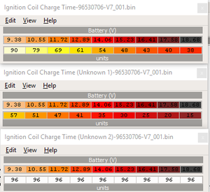

Hello,
What difference between the 3 items in ROM 96530706 (TephraMOD v7 Evo 8) :
- Ignition Coil Charge Time
- Ignition Coil Charge Time (Unknown 1)
- Ignition Coil Charge Time (Unknown 2)
I read in another post that the formula to convert "units" to "ms" is : x*64/1000.
Seems correct but the value is more different that the "dwell" settings that SparkTech send with Non-CDI COP.
Someone can tell me the best values for COP ?
Regards

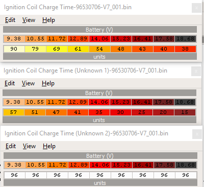

These settings work well for my Spoolin Up COP:
(Although the names are different to your tables, they are actually the same).
Make sure you replace the ignition circuit 10 amp with a 15 amp fuse before you use these otherwise you may blow it.
More details here: https://www.evolutionm.net/forums/ec...-behavior.html

if you want to change coil charge time to ms add this to xml then edit the def in ecuflash

96530706.xml attached with mrfred Coil Dwell additions

gotcha
Code:
  <scaling name="CoilDwellTime" units="ms" toexpr="x*0.064" frexpr="x/0.064" format="%.2f" min="0" max="16.32" inc="0.064" storagetype="uint8" endian="big"/>
