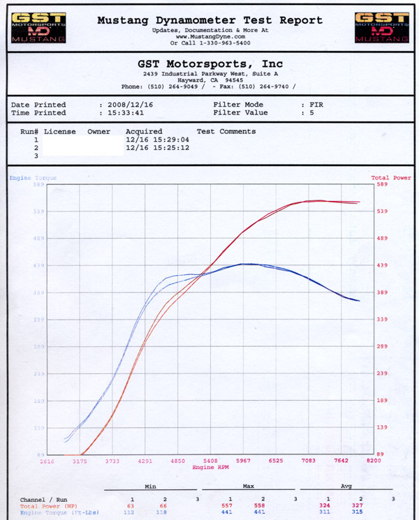

2005 Evo 8 GSR
2.3L Mike Warfield spec
Cosworth cylinder head
Buschur racing HTA35R .63 turbo kit(small hotside!)
BR cast non-tubular exhaust manifold
Kelford 272/272 cams
BR air pipe and filter
APS bov
MIL.SPEC 65mm throttle body
MIL.SPEC ported stock intake manifold
FIC 1450cc injectors
Perrin fuel rail
BR Double Pumper Fuel System
TBE no cat
HKS Twin Power DLI II
Nisei FMIC + Upper/lower IC pipes
Stock ECU
Stock MAF
E85
557 whp / 441 wtq
Boost plot 3rd gear:

GST,
Was this 3rd or 4th gear?

It says 3rd.

GST, what boost control were you using on that 35r setup?
