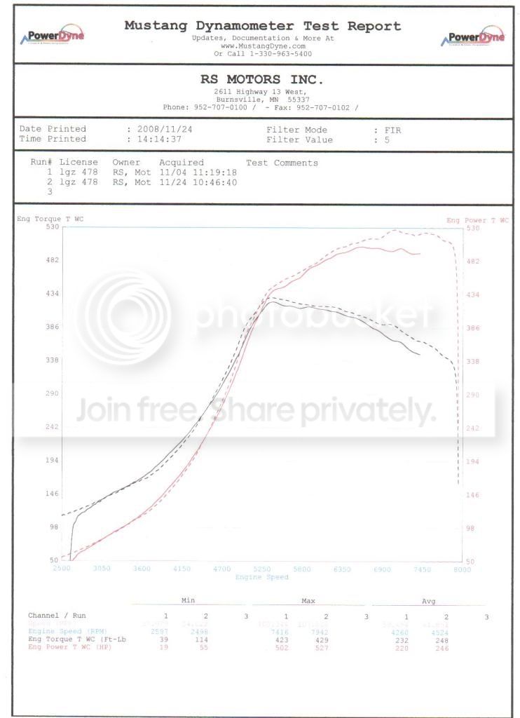

527whp on Mustang dyno
This was my old set up that I sold in January.
2.3 stroker Wiseco pistons, manley rods, eagle crank.
1mm oversize valves both intake and exhaust, inconel exhaust valves
kelford 280s, supertec valve springs, GT4088R,1000cc, 24 psi 92 octane
Magnus intake manifold, stock throttle body
The lower graph was before the magnus intake manifold. Nothing else changed but the manifold and upper pipe
Nice #'s What manifold did you have before? Where the dyno pulls done with in the same season (summer, winter..)
