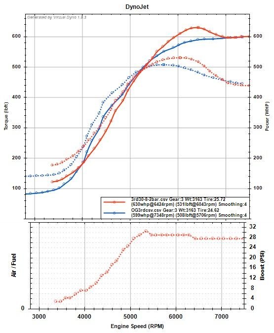

Update.
Thought i would do some 3rd gear pulls.
Before/After Stage 4 Head Fitted, Same Boost Level. Tune needs a little fine tuning still. Still 93 pump.
Virtual Dyno Comparison
VDR
Before 557WHP 488TQ
After 606WHP 521TQ
I will do some 4th gear pulls when i get a chance and a bit more fine tuning(should be around 650whp).

New tire size since the first post?
Old Jan 6, 2012 | 03:26 PM
  #49
evo4nr's Avatar
Joined: May 2009
Posts: 185
From: uk
Yes from
205/40/17 to 215/45/17 Toyo R888 ,need them to get the power down
You got me checking the dates on the logs then! Both comparisons are same wheels and tyres.
When i do the 4th gear comparison will be a different wheels/tires as i don't have any 4th gear runs with the new tyres.

why is the fule pressure att 3.5 bar ? when the optimal pressure is 3.0 bar ?
the indjector shot picture , will be bad whit higher fulepressure ?
Old Jan 7, 2012 | 01:01 AM
  #53
evo4nr's Avatar
Joined: May 2009
Posts: 185
From: uk
Upping the fpr takes a little duty off the injectors it has no adverse effect on the running of the car.

Epic thread revival!
Engine/Turbo combination still going strong 13 years later! ... haha
Looks like the old GT35R is getting a little tired/laggy but still knocking out the figures on 93...630whp , Is it a record?
Now running in a Evo 6 with wider rubber, link G4X, Fuel Cell with single 400lhr pump. Still on the original injectors and FPR
