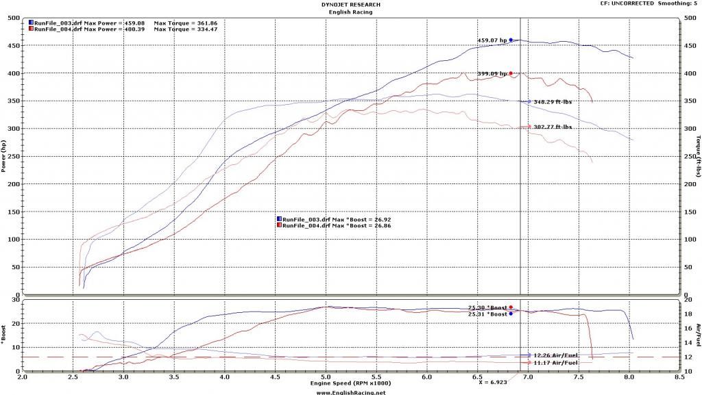

Just got back from English Racing and they worked their magic yet again! Switching to SD is awesome My current mods are in my signature, IDC was 113 on my FIC 1050's and my walbro 255 is running out of steam Hoping to get 1450's and a double pumper and should make over 500 easy! Still on a stock 2.0 so keeping torque below 400 as this is my DD, the car is scary on the street! Thanks Aaron for an awesome tune and Myles for keeping me company while I waited

That's awesome man I was tuned at 401 on my ef3 but I'm on the stock o2 my toxic fab stuff should be in this week so heading to English for the double pumper and e85 tune this just motivated me lol good numbers man
Edit I just noticed you boost hits nice I hope o2 and e85 help mine out I don't reach 25lbs till 5k :/

Congrats just wait till you make the power it should make and I'm sure it will be even more scarey.

More than welcome Jon I still think there is more left to go safely on the stock bottom end. Bigger injectors and a second fuel pump (as well as fresh primary) will go a long way.

The O2 dump seemed to make all the difference. I dont think the E85 was as much of the reason for the spool increase as the dump was. Its crazy how much it picked up over yours. I'll get a dyno graph showing the difference in a bit.

Yea Im excited now that I see this hopefully no more 5k spool for this guy lol our graphs are night and day when you look at them his is way more responsive and looks to pull much harder then mine I can't wait to get rid of the stock o2 housing talked to toxic my dump and manifold is being sent this week so I'll be in soon and I'll post my true results as well
I'm also wondering what would he have made on pump gas I see hes at 27ish lbs I'm guessing just didn't have enough fuel to make more boost would he have made close to te same on pump gas?

Jon (mcjallen) with the EF3 and O2 dump vs Jon (DSMGuy86) with the EF3 and no O2 dump.
E85 was probably a few hundred but the dump is what really woke the turbo up. Obviously the power difference is E85 vs pump but the spool is the main thing I think.

Hey Aaron I just got some new spark plugs and cop do you think that will help me a little it looks kinda like I'm breaking up a little
