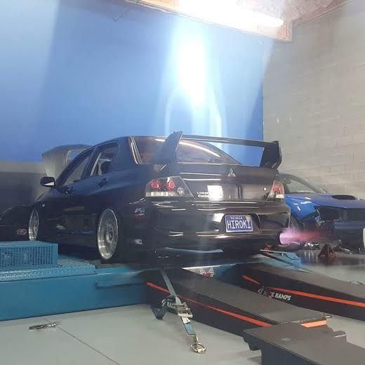

Sorry I realized making this post was useless I posted my dyno run. I just didn't want to hear all the loud mouth in my area saying how I should have made more or etc. I ended up making 550whp/420tq @ 34psi, I did a really conservative tune given that it was 105F that night that we tuned. Also I was blowing spark due to a bad COP set from spoolin up, but they totally did me right and got me a fresh pair. The car is doing 20 times better now that I changed them and I can't wait to do another dyno run to clean up the top end. I do however wish I went with a bigger turbo, but I'm still really happy with the amount of power I made and if I make around 600-650 I'll probably just chill in that power range. If any of you guys have any question I'd be more than happy to tell you. I'm no expect by any means, but i can guide you in the right direction.

is that with the new bottom end? Those are solid numbers. Definitely room to turn it up whenever you want to.

I finally got retuned and OMG the drivability is amazing, I'm not just talking about gunning it down the street. Normal driving is nice and smooth. I would recommend everyone to come to this if they want to make good and safe power gains. Devin really put in the extra effort to help me find a bunch of issues I had no idea I had going on. After we finished tuning I made 597hp / 545tq @ 37 psi (Devin @ All Access Tuning) Right next to virtual works does amazing fab work.

I took the old dyno sheet off because I didn't want to put the 1st person that screwed up my tune on blast that's all. I didn't realize that power started to drop off at 6,800 rpm, which is where I was having spark blow out. I thought it was my COP's, but it turned out to be a whole set of issues. Devin at all access tuning helped me figure out all these bugs that I had going wrong with my evo and got the car where it need to be. The old dyno sheet said 538hp with massive boost leaks dude to not having neural fittings, but when we did a base pull it said around 350hp so long story short it went from 350hp to 597hp / 545tq
