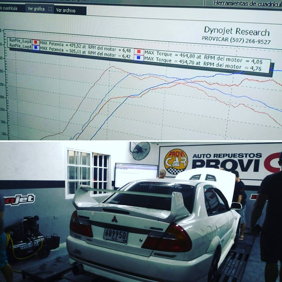

FP Black 91 octane 500+ whp pump gas
how much power will she make on e98?
2.3 stroker 9:1
cams
fp black
o2 dump
ets 4"
fic high z 1650
walbro 450
made 505 whp on 90 octane worse than california 91 3rd world poverty fuel.
Just got a Xona 8267 for it but kind of am regretting it.for it but kind of am regretting it.

How is this car making such crazy numbers on 90 oct?

You will probably run out of fuel on E98. I would dilute it down to E80, you'll still run out of fuel at about 680whp though.
