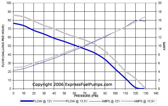

Look at your fuel pump graph. If you're using the stock wiring, you're not even getting the 12V flows (blue curve). Imagine a rewire to give your pump 13.5V. I have read that stock wiring drops voltage to 11V at the pump.
Bigger injectors, more boost, bigger pump & it would have been close
Blue is 12V.

Good news is (from what I can find), your RC 1000cc injectors are rated at 43.5 psi (my RC1200cc injectors were rated at 55psi, which means they are really 1090cc at 43.5 psi). So if we look at 43.5 psi, your injectors are rated at 4,000 cc/min. 1 gallon=3785.41 cc, so your injectors can flow 1.0567 gallons per minute. So for 1 hour, your injectors can flow 63.4 gph. Lookat your pump flow at 12V. I'm reading 57-58 gph. If your pump is actually getting 11V, you can be getting 52-53 gph.
Now, you're boosting 24 psi, so your injectors can flow more since fuel pressure is around 67.5 psi. But look at what your pump is pushing. If we look at the 12V curve, it's around 48 gph. That's like an equivalent flow of 700cc injectors running at 67.5 psi.
