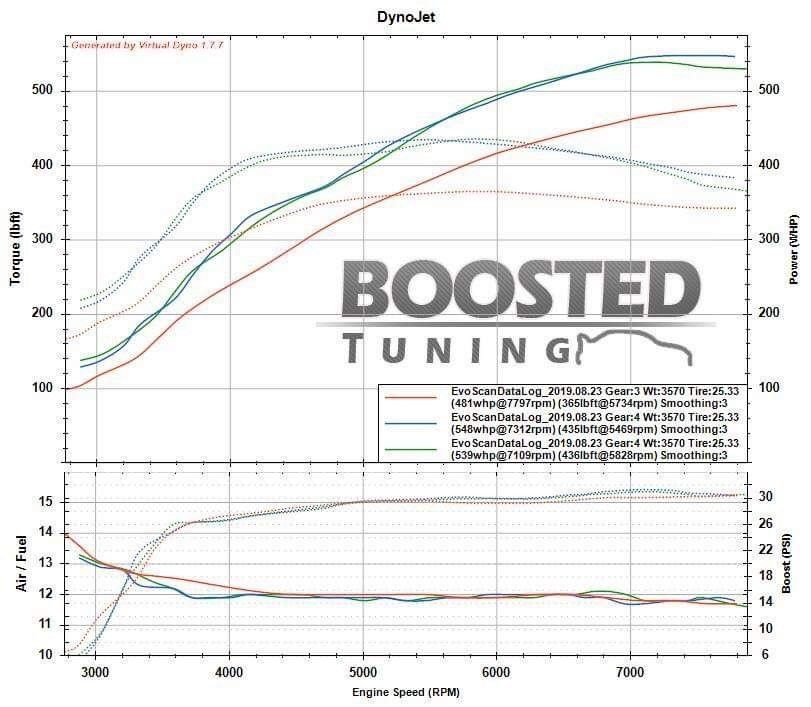

This is my final results for my BBK Full.
Car: 2004 Evo 8
Mods:
  • Built 2.0(The normal, TT rods, pistons, crank)
  • Street ported Head
  • S2 Cams
  • Manley Springs/Retainers(I know, upgrading to GSC next year)
  • Ported IM with 70mm TB
  • FIC 1220cc low z Injectors
  • Bushur double pumper(2x 255)
  • Ported exhaust manifold
  • STM Open dump down pipw
  • Invidia test pipe
  • Megan catback
  • BBK Full(ported wastegate hole) with TS 22psi gate
  • Stock ecu with flex fuel, Tuned by Boosted Tuning
  • Jacks Tcase and gearbox
  • Sheps rear diff
I've had a **** ton off issues while tuning the car, from boost leaks to crazy boost creep...It's not high HP car but a fun street car.
pump 93 - 431hp/347tq
pump E74 - 481hp/365tq

Very solid #’s !! That’s impressive for that turbo, I run the BBK-3b. What boost did you run on your top line? Was that a maxed out run and then you dialed it back?

400 ft lbs from 4000-7000!
Thats a fun street car.

That was the final run, 30psi on all the runs. The middle and last are in 4th gear, first was 3rd gear.

I have a similar engine and yet my bbk full puffs down to 24/25 psi past 7000rpm...
Could an open dump or the porting really help that much?

I'm not sure if the open dump/porting(ported to put boost creep in check) but I'm also using a 22psi turbo smart wastegate. Post you dyno graph and mod list.
