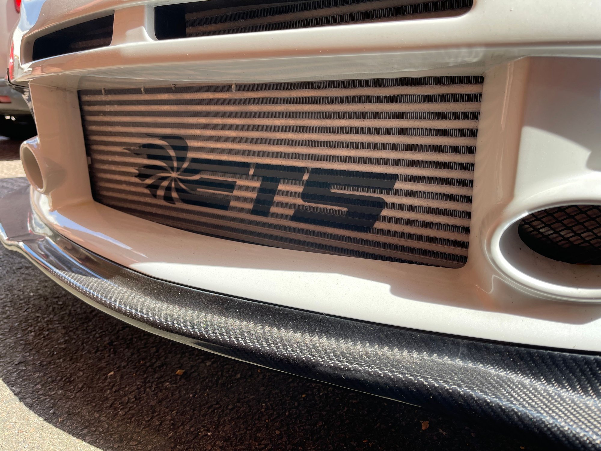

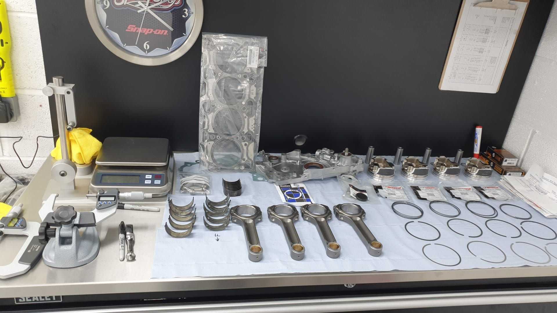

Evo IX GT Wagon (Manual), ETS 4" Intercooler, Radium fuel system and pumps, 3" IC pipe kit, 4 bar map sensor, Precision 6062 kit (ETS), Billet crank, Oliver rods, Wiseco pistons, stock head with uprated springs and retainers. Haltech Elite ECU.
The engine is freshly built and run in, my tuner has mapped the car on the Haltech (he really doesn't like it, lol) and said we're pretty much out of flow at the top end to make any more than 624hp (499whp). The transmission I have is being rebuilt but I want to have the drenth I've bought installed. Tuner says he needs syvecs to deal with sequential and get to the power levels safely.
My question regarding cylinder heads is do I need to spend all the money on a stage 3 head to make 750hp, or will oversized valves, a good polish and cams get me there?
Car will be running on 99 octane pump fuel or ratman (renegade) race fuel. I have no desire to run ethanol.
