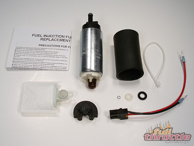

hmmm now that i think about it.. i used to hear the whine of the pump, then i installed grounding kit and the whine just "magically disappeared".
Old Apr 8, 2005 | 08:34 AM
  #34
bolsen's Avatar
Posts: 1,940
From: Milwaukee, WI
Originally Posted by Knyght
The walbro's will fail due to a low voltage condition.
dafarmer69: We call it the black booty. It's like those coosies for beer cans to keep them cold. It's a foam rubber isulation cover that should be supplied with the pump, it's black in color and should be slid onto the metal part of the pump. Should keep the noise down, and keep the pump from corroding. In the picture it's sitting right next to the pump on the right. I would suggest using the tie strap with the foam around the pump attaching it to the side post of the fuel pump bracket.
I've had this in my Talon for 2 years, no loud whinning, just make sure the pump was installed right and has enough power.
Also the ones with loud pumps may want to check if they bought the 255 HIGH PRESSURE version by mistake. Those are pretty loud and not needed for most applications.
hmm I didn't get any of that when I bought it...

yeah, i only got thep ump as well. not all of that's necessary, besides maybe that sleeve being pretty handy. the tea-bag, bottom plastic piece, the rings you can just swap over from your stock fuel pump assembly. a fuel pump install isn't exactly rocket science, just take it out, put in the new one and set everything back up as it originally was.

I doubt this 'kit' was changed. You might have bought it used or an open item or something.
When you buy a walbro fuel pump it comes with everything in the picture, no matter what. These kits are universal and fit's chevy's ford's honduh's mitsu's etc. Unless the company you bought the kit from opens the box, takes what they need and repackages the "kit" with just the pump.
I beware of any company that doesnt show you pics of whats included when you buy product kits. CYA people (Cover Your @$$) Seeing is believing! That way if you get a 'kit' and somethings not there you can take action.
