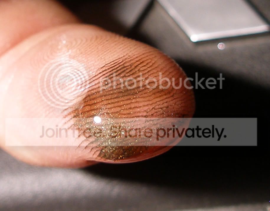

Not quite sure why so many want to blame rod bolts. Rod bolt failures are typically tensile from forces due to high rpms. Running lean leads to detonation which results in compressive pounding of sorts transmitted down the rods to the bearings which leads to the bearings getting pulverized which would lead to metal shavings in the oil. High rpms is what kills rod bolts the quickest. Bearings clearances terribly screwed up (most likely from deterioration due to detonation) can also stress to a certain extent the bolts but nowhere near what high rpms can.
Anyone who has ever watched something being machined can see how fast a relatively slow turning part or machining tool can produce metal shavings. Just the same, a bearing going out in a motor commonly spinning 3000-7000 rpms can produce a lot of shavings and contamination in the oil in very little time.

Does anyone really mean to tell me these finely ground shavings will be the result from a motor blow this catastrophic? I highly doubt it. Looks like that bearing had been wearing for some time, where as the flash was only present for around 9-10 days prior.
that many fine shavings can be generated in a very short time. If you drove 50 miles with the bearing starting to go (either from knock or stretched rod bolts) it would have no problem generating that much debris. I know, I've broken more than a few racing engines and when a bearing spins it seems everything in the world is covered with copper fairy dust.

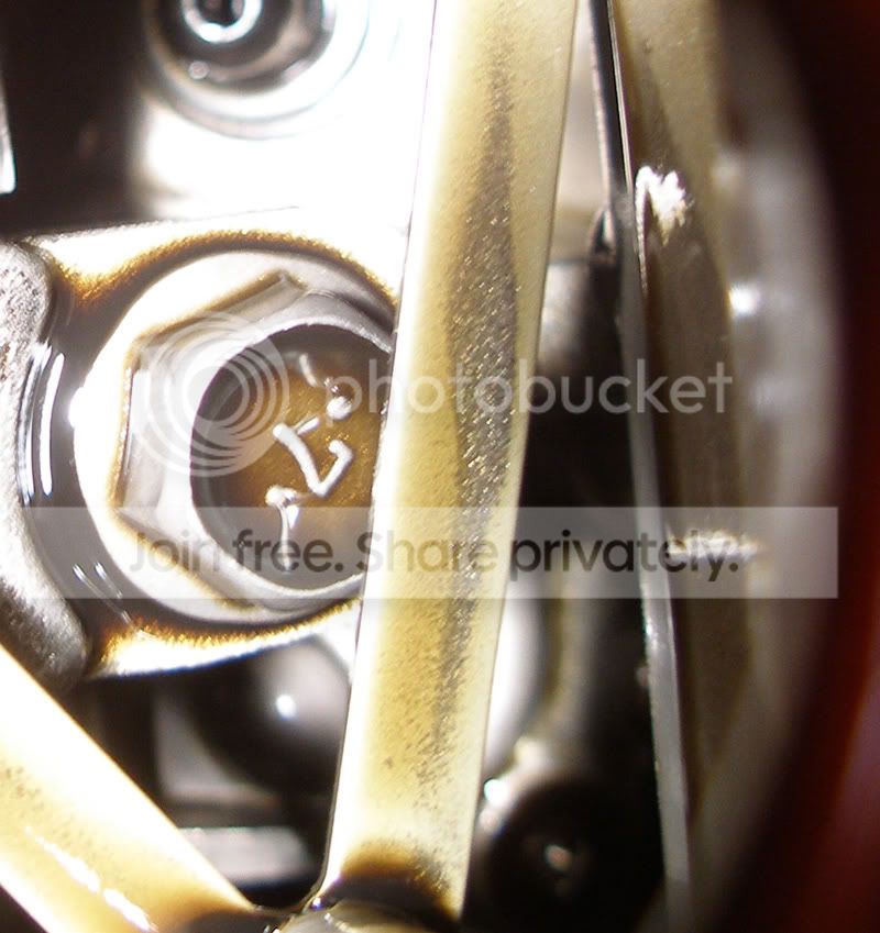

UPDATE:
Dealer has the head off and the District Rep swung by and took pics. He is sending them out to California this afternoon for inspection, where a decision will be made. These are the things the Service manager noticed and told me on the phone:
- valves in cyls #1,2 are broken (obviously, there were pistons free floating)
- valves in other cyls look to be damaged (not unlikely for timing to get out of whack on a BLOWN MOTOR while it spins down)
- looks to be a slight light grey on the valves themselves
- cylinder walls are scored in all 4, front and back, not side to side (I believe)
One thing I noticed but did not take pictures of, is that the spark plugs look good, no detonation marks. Light grey on both #1 and #2 plugs. I will take pictures of these later today at the dealer.
This is what they mentioned after taking the head off. They did not pull the pan yet, and are not sure if they have to.
..I will be swinging by there tonight at 5:30 to take high resolution photos and post my results.
