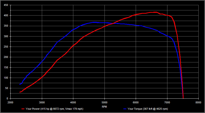

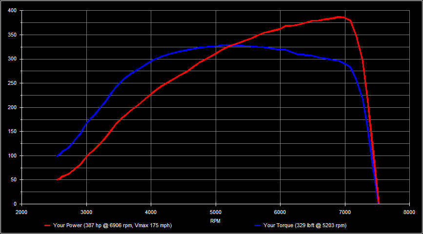

I am a bit hesitant to post these as I have found from alot of road tuning on my personal evo and others that the DLL graphs are really only good for comparing before/after tweaks to tunes on the same stretch of road on the same day.
The numbers themselves are all over the place from car to car, place to place, etc etc. Sorta like comparing dyno numbers and curves from different dynos.
With that disclaimer, here are atvalets DLL graphs from the dyno:
91 octane:
100 octane:

So on 91 octane DLL gives hp numbers that are 14% higher than the numbers on a Mustang dyno. For torque the numbers are 11.5% higher.
I ran 5 logs for my Evo 8 back when it was dynoed on a Dynojet in DLL and DLL gave on average LOWER numbers than a dynojet by 7% when it came to hp and 15% when it came to torque.
