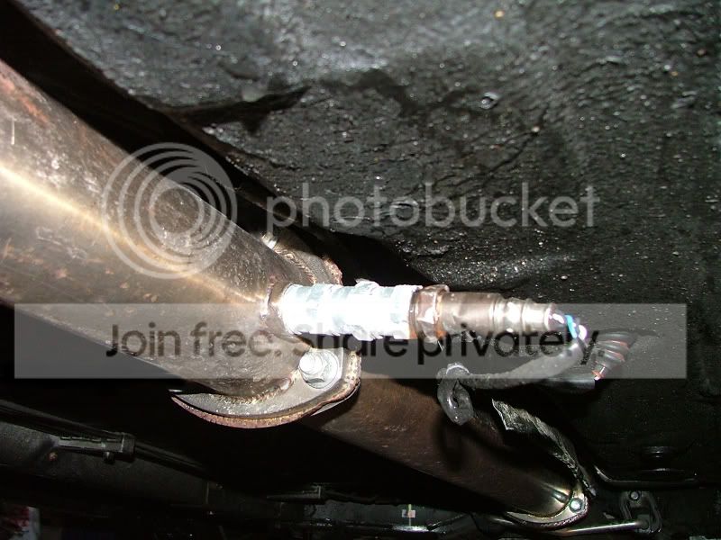

This is the mechanical fix that I did.
An easier way would just have the light disabled in your ECU but I didn't want something to happen to my car and me not know.
