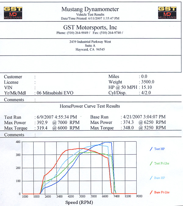

Originally Posted by scorke
A maxed out green might make close to this yes, but it will also make a boatload more tq, and hp before 5k and will probably only be behind this particular setup at 6k or so at which point you would probably be shifiting in the green'd car anyway.
You mean like this?
ATP GT3076 kit Vs. FPgreen, both on 100 octane, both at 26psi peak
Green and dark blue is ATP, red and light blue is FPgreen

Originally Posted by razorlab
You mean like this?
Just like that
