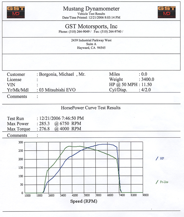

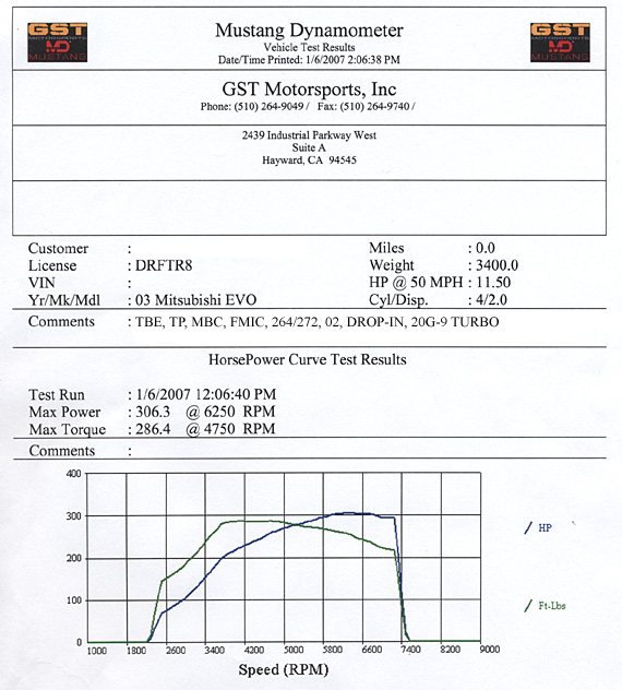

A customer. The TB seals wouldn't even let me pressurize past 5psi with a boost leak test.
I've also seen a boost leak at a FMIC rob a car of 21whp/10wtq
with boost leak:
after fixing boost leak:
