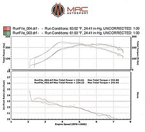

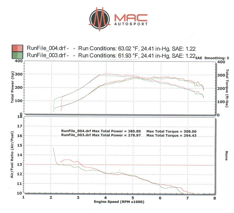

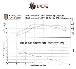

Dyno'd on MAC Autosports' DynoJet in Denver, roughly 5,500ft above sea-level.
The results were as follows:
1st run:
- Pulled air filter.
- MBC at 18psi peak, tapering to about 16psi at redline.
- Uncorrected - 229 HP / 242 TQ
- SAE corrected - 279 HP / 294 TQ
3rd run:
- MBC at 20psi, tapering to about 17psi at redline.
- Uncorrected - 235 HP / 253 TQ
- SAE corrected - 286 HP / 308 TQ
No other mods. Prior to fitment of the MBC I would see ~18.5psi peak tapering to about 15psi at redline, so my BC settings for the first run are fairly representative of stock boost control IMHO.
The air filter has been on the car for 7k miles and was pretty much black. Hence I pulled it to simulate what I might see with a high flow foam cone.
Raising the boost that extra 2psi made a significant change in my AFRs, resulting in them dropping below 10:1 at ~7,300 RPMs instead of 6,800 RPMs. The car is generally rich (<11.5:1) from 5,500 RPMs on up.
For the record, most stock EVOs seem to show about 200WHP on this dyno. I seem to have something of a factory freak.
Regards,
-Pace

SAE corrected. I don't pay too much attention to this as the SAE correction factor does not apply well to forced induction cars. But it's useful to compare for anybody else that has SAE corrected charts.
-Pace

Corrected
Uncorrected
Air/Fuel Ratio
When comparing the uncorrected numbers to those at sea level, mine are only about 10-15hp lower. SAE...not always what it seems
