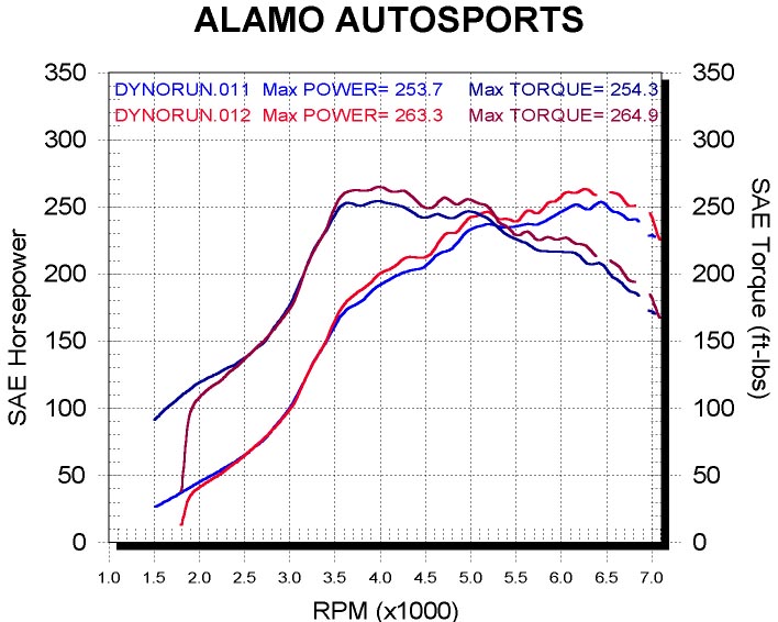

Here is my dyno testing after installing an under drive pulley from Alamo Autosports. A very noticeable 12-5WHP is measured across the power band, and the new crank pulley is about 5lbs lighter. I have an BLITZ turbo timer so I was able to monitor voltages before and after. There was no significant change in voltage, maybe .2-.3V lower, even with AC, lights, stereo. Other than the engine reving faster and better acceleration, I would not know the smaller pulley was there.
I have used under drive pulleys in other applications with no reliability issues accept minor voltage fluctuations at idle with light,AC,etc. That does not even seem to be a problem with this car, possibly due to the slightly higher than normal stock idle. I have also talked with several DSM/WRX owners who have used under drive pulley's for years and experienced no reliability issues. So save the gloom and doom BS, I already posted a queery on this forum and got nothing but positve feedback.
Bang for the buck IMO this is probably one of the best mods you can do to your car. It is stealthy, and most likely will improve the reliability of your accesories, especially if you spend a lot of time running high RPM.

Nice Dyno numbers! What mods do you have done besides the pulley. I'd like to get one of those . Are they going to sell these soon, or are you still in the testing stage?

I have a turbo back 3" exhaust (RMR) with a Random 2.5" high flow cat (going to 3" cat soon), A K&N stock type air filter, Greddy type-s DV, EBC Greddy prfec B specII (running 19.5-19PSI), oh and Red Line synthetics in the entire drive train.

Oh and this is an in stock part that can be purchased right now. The kit comes with three pullies but I just did the crank pulley, it's much cheaper and far easier to install. I could not honestly see any real advantage with the alternator and water pump pulley used in the kit, (they are the same size as stock).
Alamo has these in stock 817-860-4300.
The crank pulley is not that bad, you have to take the right front tire off, remove the plastic cover and the pulley and auto tensioner is right there. I watched but I did not install it myself, hey they offered to install and dyno test it. I like doing my own stuff but... it took them about 1/2 hour.
