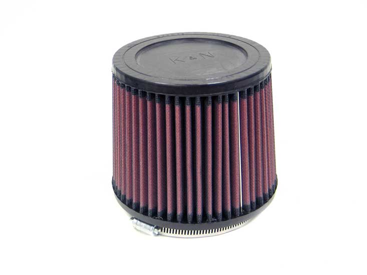

hey S2kracka,
Great results, but my one question is... What model K&N Filter did you use? The one I got, looks similar to the Amsoil/ Vibrant/ Buschur models with the exception of the open top filter.
Check it out: (K&N RU-4260) <--- comes with ETS Intake kit for the stock MAF Pipe.
https://www.evolutionm.net/forums/at...1&d=1231096681
http://www.knfilters.com/search/prod...x?Prod=RU-4260
I strongly believe if you had tested this model, you would've seen better results.
Also I'm glad I kept my old style burshur air filter, I might have to take off the K&N and throw in the Buschur.

Originally Posted by 2006EVOIXMR
hey S2kracka,
All In All, Great Post
I actually disagree with you here. The larger of the two K&N's is the air filter K&N chose for their Typhoon and FIPK kits; its actually much larger in person than it apprears in the pictures, and due to the very wide base it has about the same filtering area as the others do. The ~10whp gains with the Perrin over a K&N filter have also been reported by CBRD (they tested one similar in size to the Vibrant and Amsoil filters) . When I had my S2000 is when K&N started to get a lot of bad press regarding poor quality control, poor filtering quality, and sub-par performance. This test just backs that up and I'm very interested to hear, if K&N responds to me, their reasoning for the poor performance.

The FIPK K&N is what K&N recommends for the car. The surface area of the filter media is more than enough to make it comparable to these other filters.
I don't think anyone mentioned the details of this one yet, but the SMALL K&N filter we tested was about 2.5" of filter media in a cylinder, it fit really well but it was *HILARIOUS* hearing this filter on the dyno. The intake sounded like when you stick a vacuum nozzle on your skin, pffffffffwwwwwtttttt!!!!! The car was obviously not getting the air it needed and it would knock randomly, making it perform super inconsistently.
