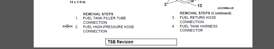

How's this?

I'm scared now....
Old Jul 2, 2012 | 04:28 PM
mt057's Avatar
Posts: 1,529
Likes: 12
From: DFW
Lol. It looks to mainly be a bunch of hose/wire connections. There should not be too many bolts. I have not attempted this though...
