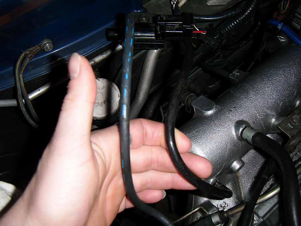

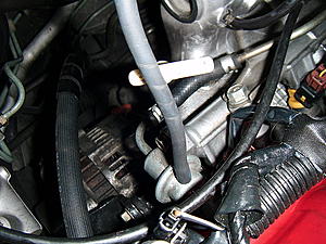

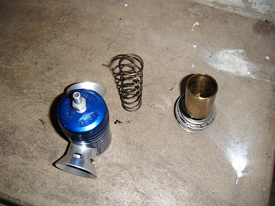

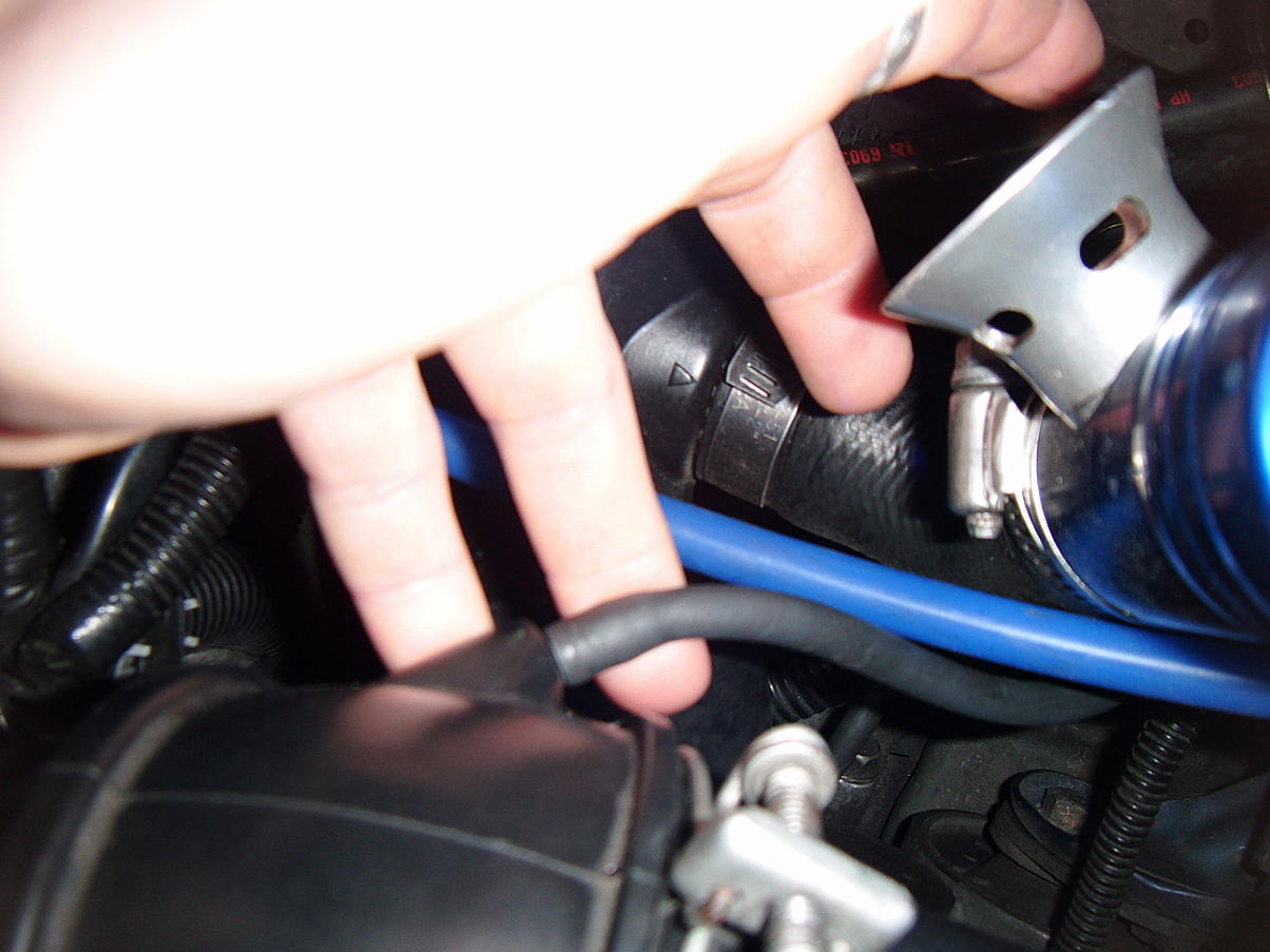

yea it was.. but i think i may have fixed mine. im not sure tho as its still lumpy sometimes. but i replaced one hose that runs from fuel reg back to the plug thingy lol .. plus i also replaced the hose that runs from the standard boost controller solenoid to the intake part and it seems to be ok.. heres a pic of parts i move/replaced. as i was taking photos i noticed that i could spin my bov!! lmfao it fell apart when i pulled of!!!.. gave a clean up and put back on fingers crossed!
