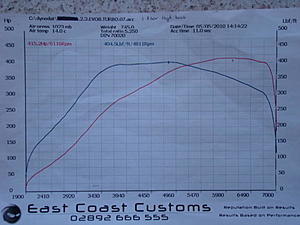

I used eagle crank, manley i beam rods and wiseco pistons. I'm still on standard 8MR turbo (for now) and it can rev to about 6,800. it made 415/405 at the fly at 1.8 Bar boost and it feels alot smoother to drive since been stroked and pulls very well in every gear
