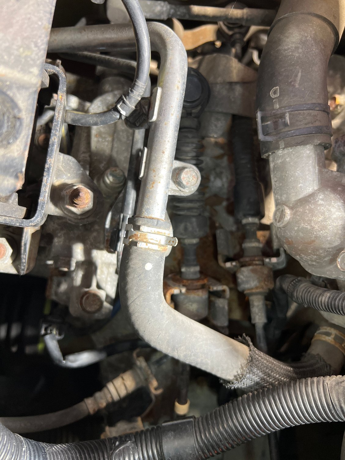

Any M/T Lancer folks on this same topic
Sorry to revive this.. I am having the exact same issues with not power to reverse lights. Already ruled out my fuse box. I am trying to find this back up light switch on a manual transmission lancer de. I can’t for the life of me find anything that would match to the switch I’ve seen pictures of. Doesn’t seem to be in the same location as the Evos

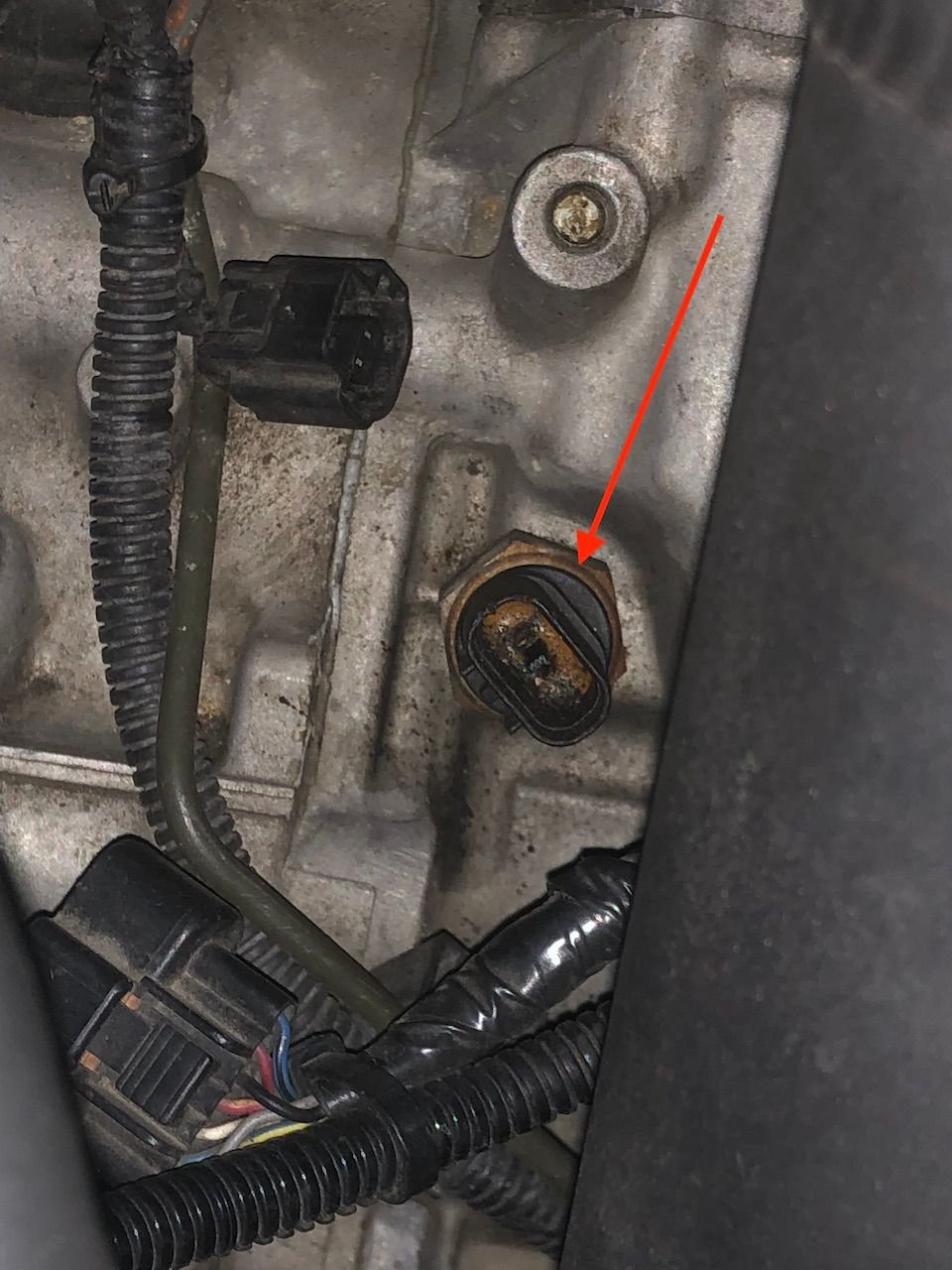

Hi! I made a photo of my gearbox. Sensor is right in the middle. My is disconnected since I swap 6 to 5 speed.
