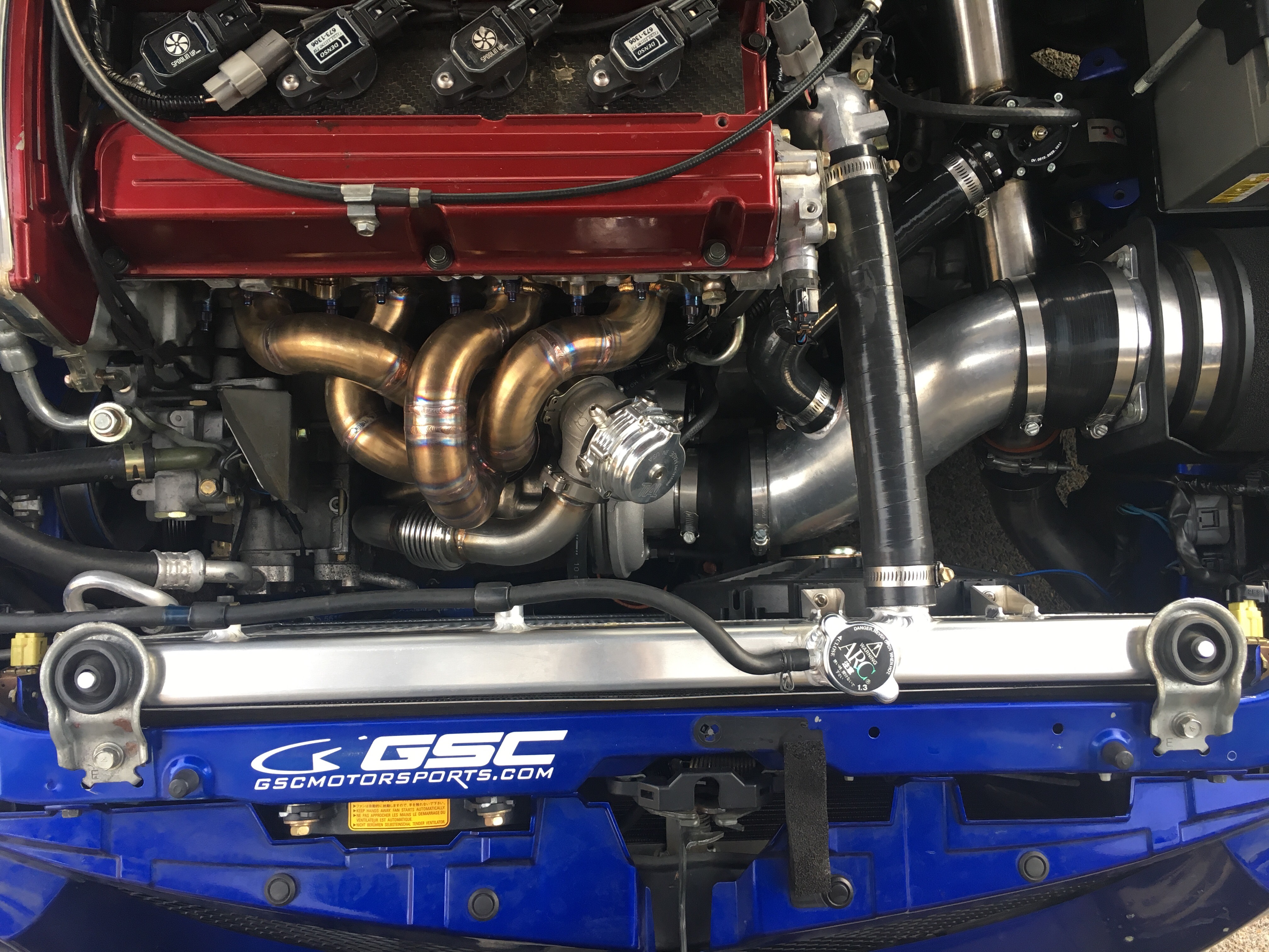

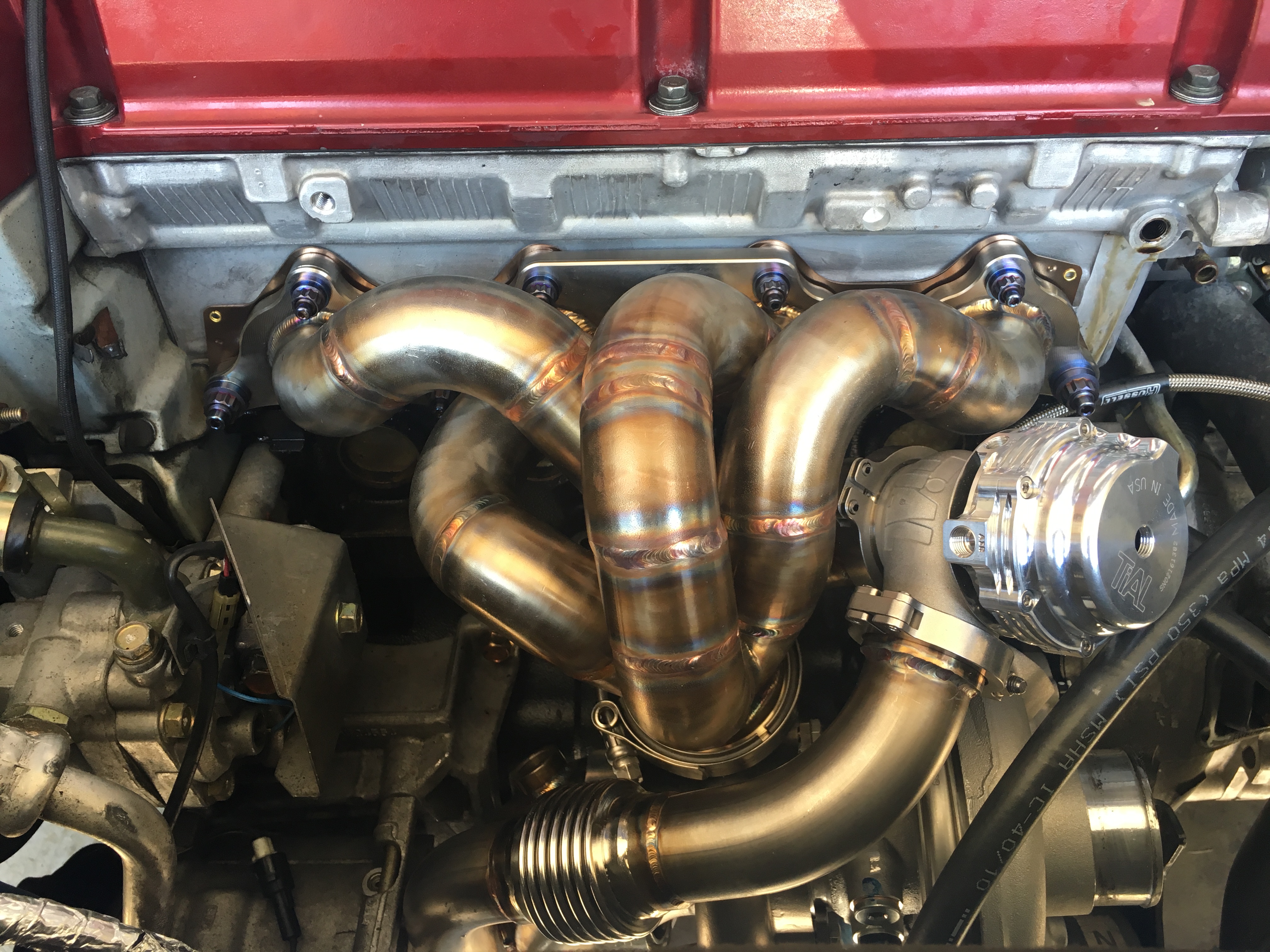

Originally Posted by efrevo
brainAWD what is your reason for using vband on 7163? not the Crbd t4 7163
No option from CBRD for twin scroll. I looked at a full race kit with a
Twin scroll housing but when I called the person I talked to on the phone
Rubbed me the wrong way. So my next option was CBRD. I have to say I'm am
Happy with the quality.
Turbo is on. Just need to finish a few little things then it getting a retune
On the 1st.
Will be interesting to see the difference between my old hks 7460R and this new
EFR7163.

All done with the install. So far I'm really liking this turbo.
From the little driving have havw done the turbo is supper snappy at
Only 1/2 throttle and letting off my 5K. Seems to spool faster then my
Hks 7460R. But will know for sure on the 1st as it will be on the dyno.
