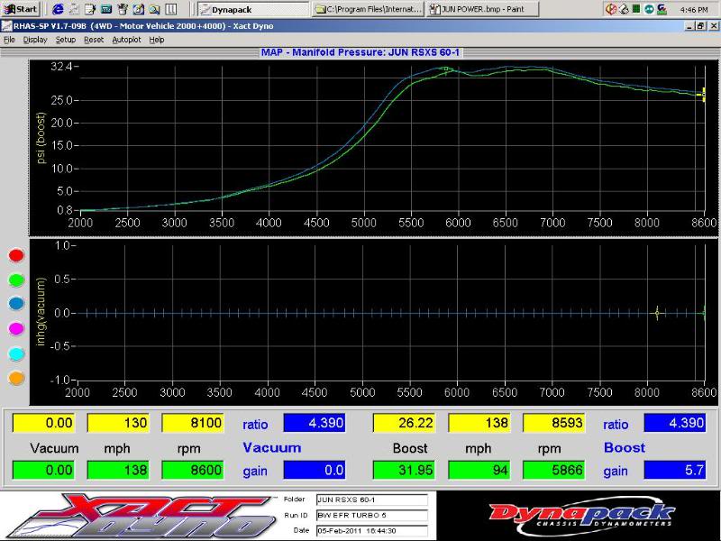

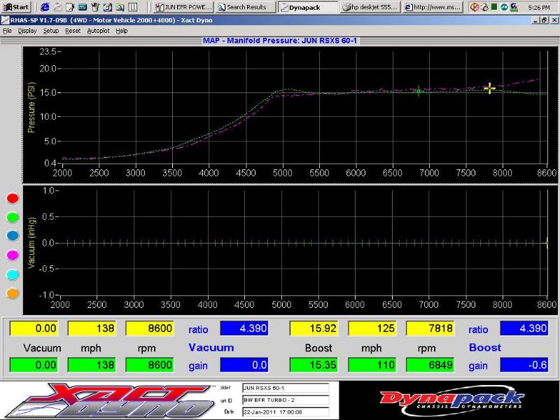

pictures stolen from this thread, i hope he doesn't mind me using them.
http://forums.clubrsx.com/showthread.php?t=755332
GT3582R vs BW EFR 8374, both with 0.82 exhaust housing.
Please bear in mind that a correction factor of "SAE" is very easy to botch with ambient air temp sensor placement, i'd be much happier with uncorrected.

thanks for posting ^^^
it seems the 8374 has the same spool, but makes more power everywhere. I'm really temped to get the 8374, but the 7670 looks like it will do so well.
