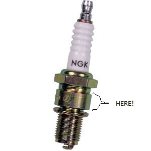

So the oil is where on the plug? A part that is inside the cylinder or a part that is not in the cylinder and only inside the spark plug tube?
Is it wet inside the spark plug tube? Is it wet on top of the piston?
It sounds like its just the valve cover gasket ring but if it is inside the cylinder part then its from the intake sucking in oil from the valve cover via pcv valve and the first port it runs to is #4....Look at my pic and you'll see what I mean since it is what I found in my case. Although it's not number #4 its #3. At least I'm pretty sure it's the reasoning for mine, I just dont know why it wouldnt be in my #4 also but you get my point. Prob just the valve cover tube gasket though, you can see it when you look down the tube it looks like black rubber oozing out, depending how tight the VC bolts are anyway.

This isn't the actual spark plug, or even an Evo plug. I just googled a picture to show where the oil is. Shining a light down into the cylinder, the piston doesn't look shiny/wet.
