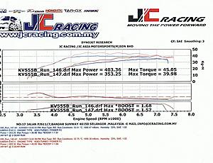

Hi guys here are my dyno chart for your kind comment...

Hi Aaron, any comment on dyno chart?
