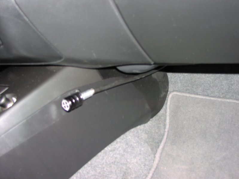

By the way...here is a pic of my Hallman Evolution Pro Rx....no need to pull over to adjust boost

You arent scared of a passenger twist? You ought to put a $ on it
