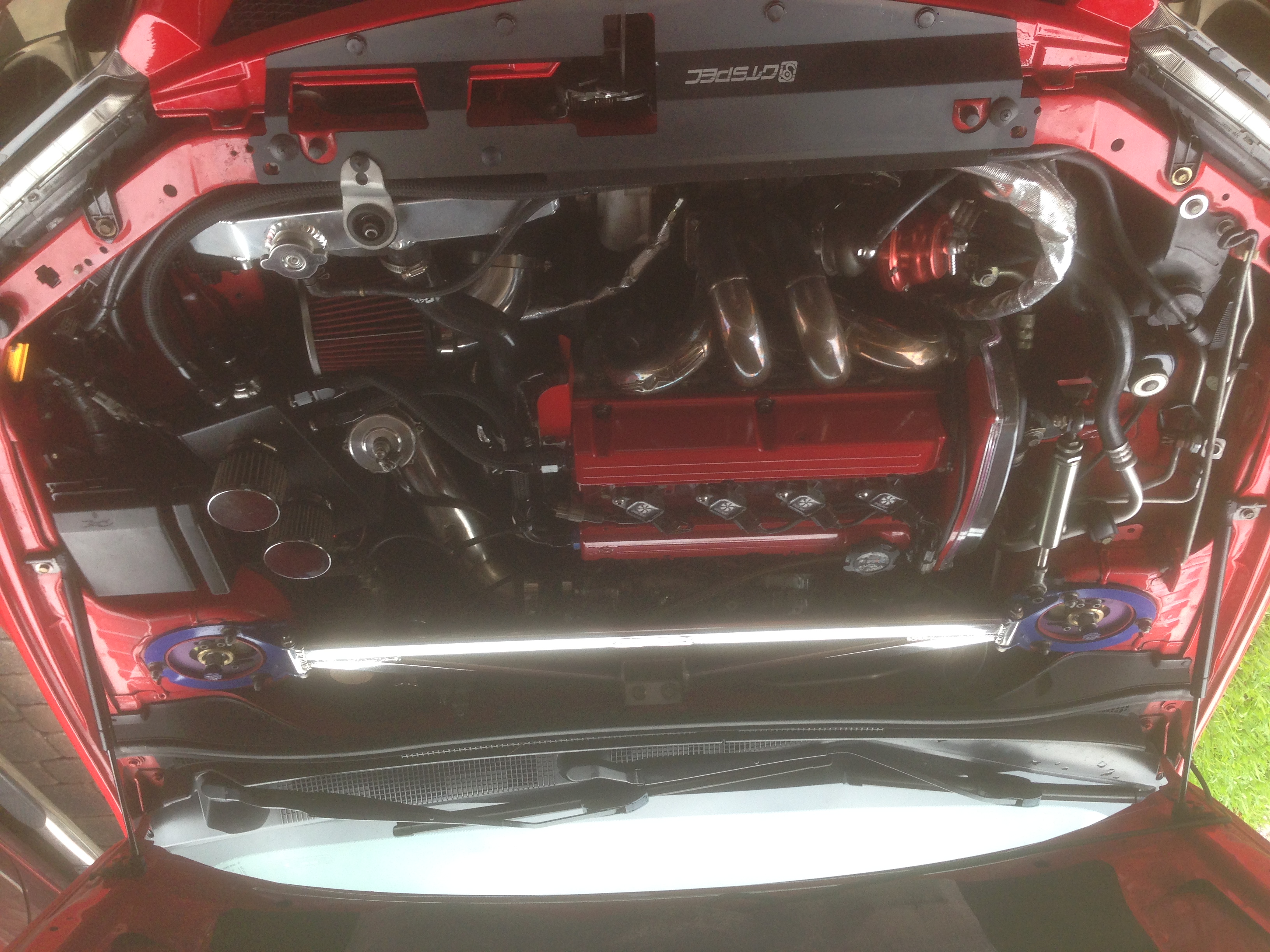

Me too. I'm also using the civic half radiator. As long as I'm driving normal, it's okay. But if I street racing in the middle of the day at 90-100 degree. Trust me the temp gauge will shown more than 3/4 high. It will go all the way up if I keep running hard on it.
Last time I drive normal , it heat up a lil bit. But when I let go the gas for a lil bit, the temperature goes back down. I change out to a new thermostat and it's fine again.
Obviously, we all have to remember that if you have a smaller container...it will always heat up easier than a big container.
I would recommend a better brand than a civic half radiator. I also have the high speed 12" spal fan , not the cheap Ebay slim fan.
It save money if you want to put ff setup.
Attached Thumbnails INSTALLED: EBAY Civic Half Size Radiator!-image.jpeg
