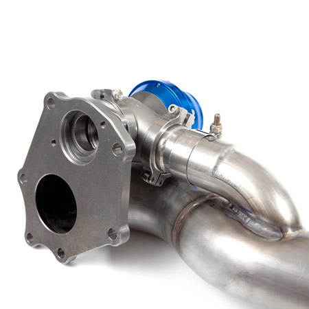

I would mount the EWG to a custom o2housing with WG flapper removed. Similar to this
http://www.atpturbo.com/mm5/graphics...-023_450-3.jpg

This is a bad idea. you are bleeding the pressure off one of the scroll's only. This will cause a turbine housing failure quickly.
Originally Posted by ineedmorepsi
This is also a bad idea. This will increase boost threshold by 500-800rpm, making for a very laggy car.
If you have already welded your internal wastegate shut, i would recommend adding a wastegate pipe from runnings 2+3 to your existing pipe. Make sure they are divided all the way to the wastegate valve.
Example pic
This keeps the scrolls seperate until the wastegate valve opens.
Cheers, Mike
