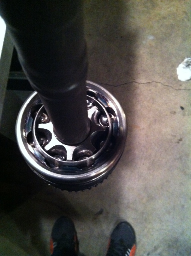

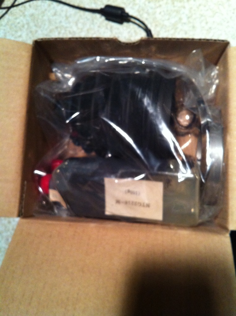

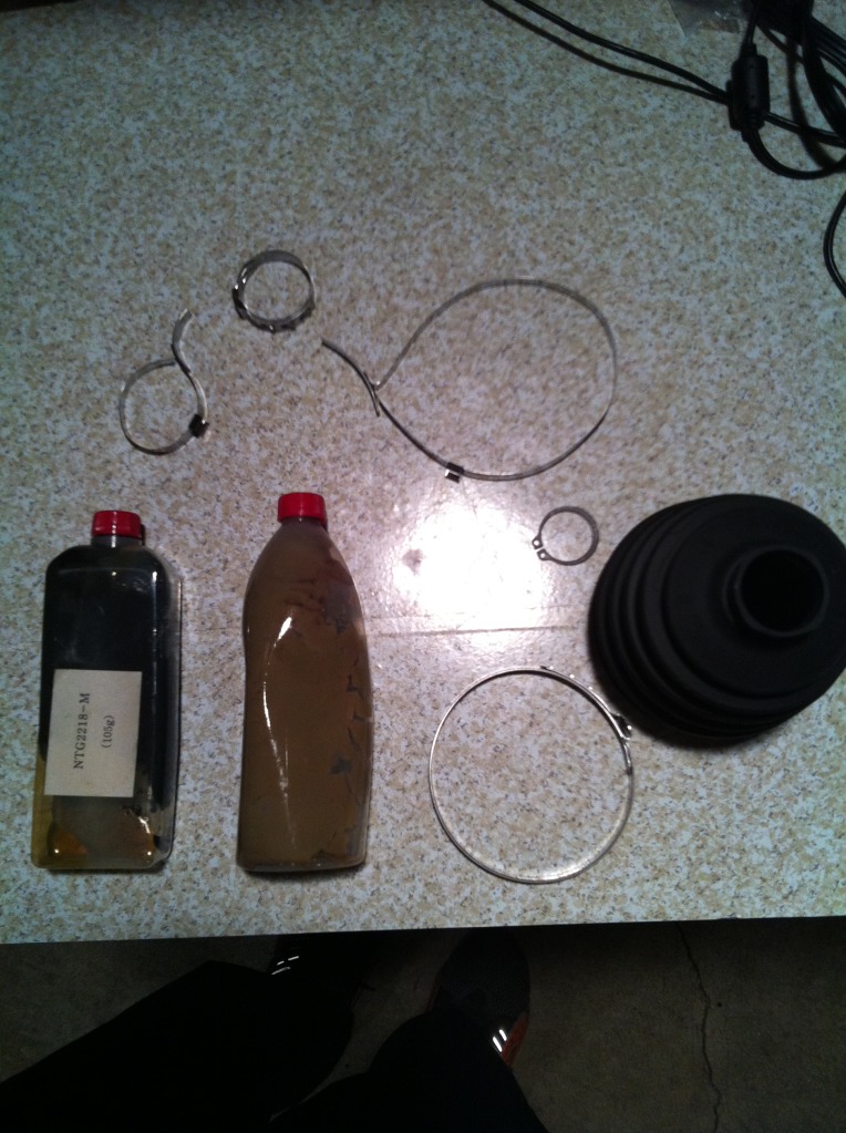

wow! Tons of responses. I am pretty car oriented and realized that the outer CV does not come apart. So I did remove the axle and used the grease (graphite on the outer, and the brown, lighter grease on the inner. Little write up I did, and pics.
Alright I am in the garage, it is time for the axle boot. The outer boost on the driver side is torn, so it is time to repair the issue! I have ondemand5 which is pretty awesome, it also helps you understand certain precautions most people may not know about on specific cars. So not all axles are the same, ha I knew that but it was quite apparent when i took off the boot on the outer axle on the driver side.
You actually have to take off the axle, remove the inner two clamps, take that off, remove (1) C-clip to take the spider gears off, then take the boost off, and then you're able to get to the outer boot! Gees a lot of work lol to replace one damn boot. Also ondemand stressed, get all the grease out of the axle, mixing old and new grease is not good at all. They give you two tubes, one for the inboard CV and one for the outer CV.
New boot and parts.
In case anyone wants to know, the black grease is for the outer CV, the darker brown is for the inner CV, you have to [CLEAN] all the old grease out, if you do not damage will occur. They also included the new bands or clamps, and the C-clip for the spider.
After the outer CV was cleaned of all its old grease. It was actually breaking down, the grease was not fluid like, so I am happy I was able to get in there and replace it.
