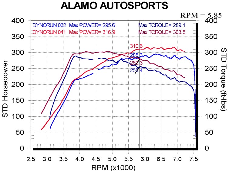

Couple of other observations with the cams, I had to jack up the boost controller to make the same boost. I am running a Profec sepc II, I spent most of my dyno time getting the controller set for the cams and playing with cam timming. You can see from the torque curve that the boost does not over shoot and is more stable in general with the cams. The air/fuel ratios did not seem to change much and I did not have time to change ignition timming, although later on street tunning I found that I could run more timing without knock so...
For the cam timming I settled on -3 intake and -4 exhaust. Here is another graph after I got the boost controller set up a little better, this is around 20 PSI tapering to 18. On the street it holds boost much better than on the dyno. The numbers are ok but look how smooth those curves are! This is with zero smoothing!
Oh and this is blowing through a 3" Random high flow cat
