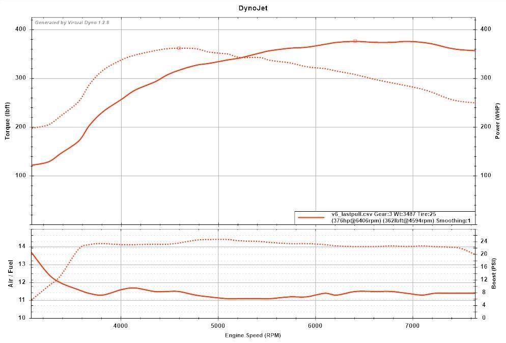

I recently installed the FP 71HTA with 84mm cover. I came from the Evo 8 with 10.5 housing. Turbo feels great, waiting for my 3port to be installed since boost isnt holding in upper rpms in 1st-3rd gear with stock
BCS. Here is a virtual dyno run in 3rd gear. I took it to ATCO last week, did 112mph, gained 26mph from the 1/8th to the end. Hoping once boost holds up high i will get another 2-3 mph out of my traps.

You should be able run more boost on 93 anyways. Turn that thing up to 25-26psi and hold it flat out the top.

Ya that is what I am hoping for, holding 25-26 psi on 93. I want to play with E85 afterwards :-)

Man, would I love that dyno sheet.
Really nice results...
You might want to add more preload to the WG and/or use stiffer WG actuator and not just rely on 3 port.. although 3 port is much better than stock..
