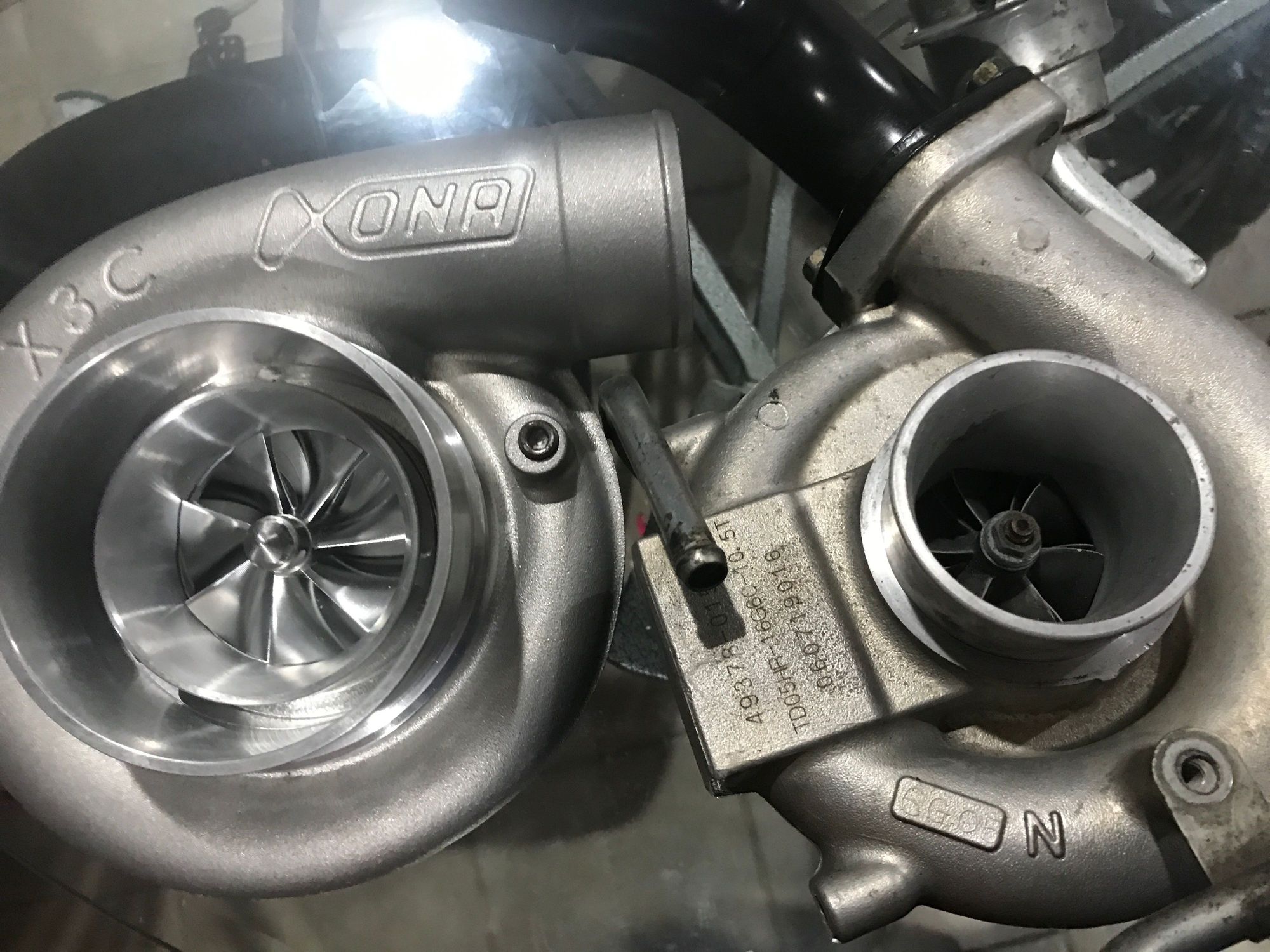

Just purchased a Xona 7864 vband, looking at downpipe options that don't break the bank. Could I just use a fp cast 02 housing to use my stock location downpipe or is there any others options besides a 750$ vband downpipe thanks 😬

A Xona 7864 requires a full turbo kit. It's not going to use the stock exhaust manifold, down pipe, or LICP, wastegate actuator, etc.

I would imagine the Xona is a drop in for any kit that fits a full frame Garrett as well?

Yeah, they fit where Garret's fit. But the way the OP worded his question, it sounds like he thinks he ordered a stock frame turbo...

I was going to use the cast housing from he fp black and weld a flange on my aftermarket downpipe

The turbine wheel isn't even remotely similar. You need a turbo kit for that turbo. You should have bought an Evo 9 Zero if you wanted a stock frame turbo with 86HTZ compressor.
