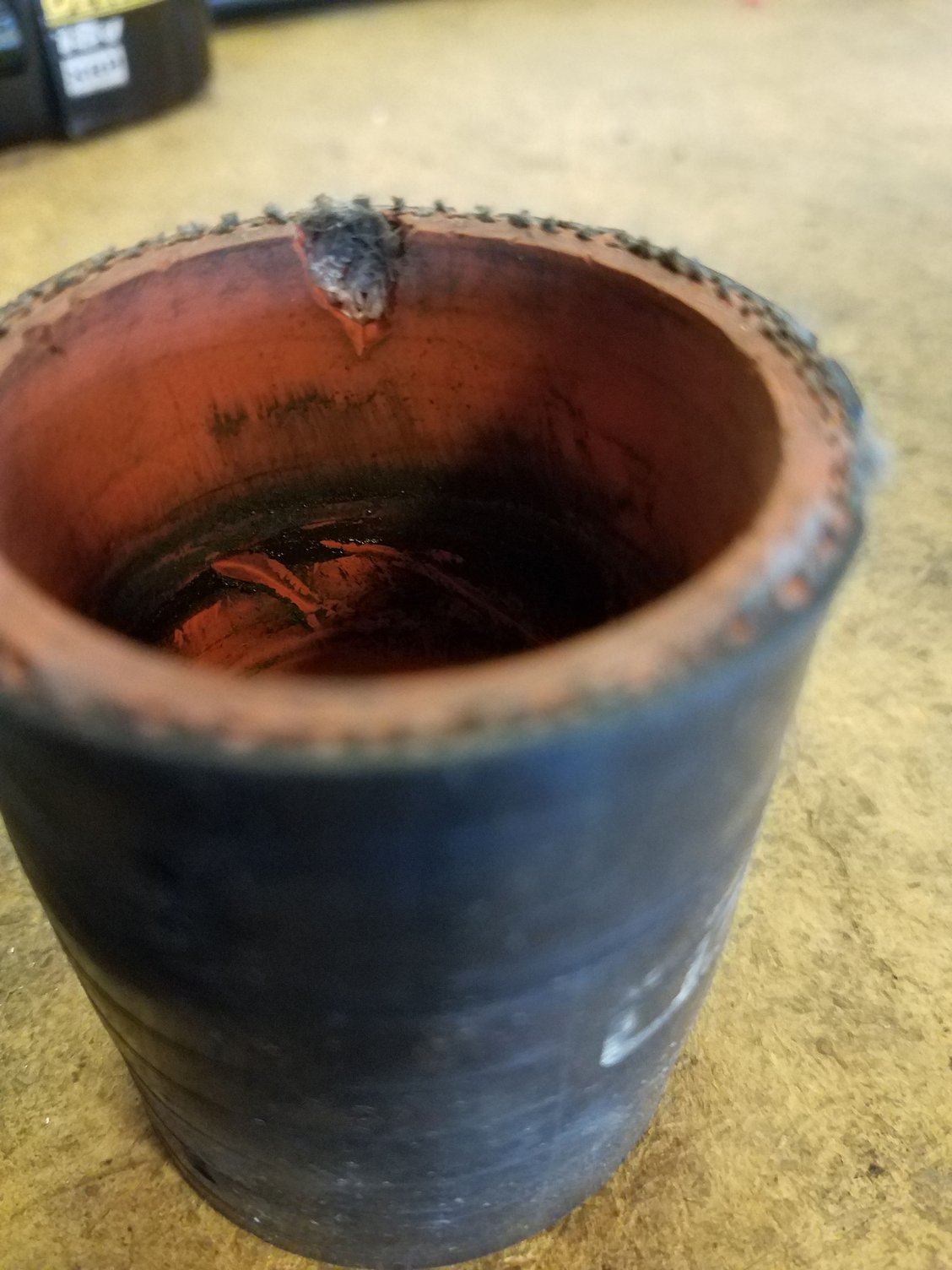

Yeah, that's what I figured. It felt like popping an IC coupling.. but since they are all still on, I guess it would have had to be fuel cut. The log supports that, from what I can tell, though I'm not sure.
It's not fuel cut. Injector pulse width goes to zero during a fuel cut event.

I can 100% guarantee I did not drop a rag into my IC piping, air inlet, etc.
The car did a 3rd gear pull perfectly. On the next pull, I heard the pop and the car lost all power. Got on the gas and it did it again. After that, the pull are without incident but 'Been rich ever since.
Not a rag, but I appreciate the suggestion. It's always the weird, unexplained things that cause problems and we never think of them LOL
Ok, I misunderstood. I thought the original issue was persisting.

Yes. I found a possible cause. Fixed. We'll see, now. If all is the same, I'm just going to start leaning out the fuel tables.

Replaced the coupling. No change.

Boost, leak, test.
Damnit, was hoping that would be the gremlin
