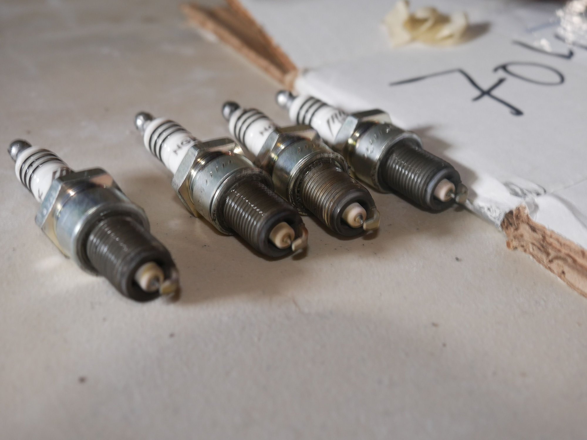

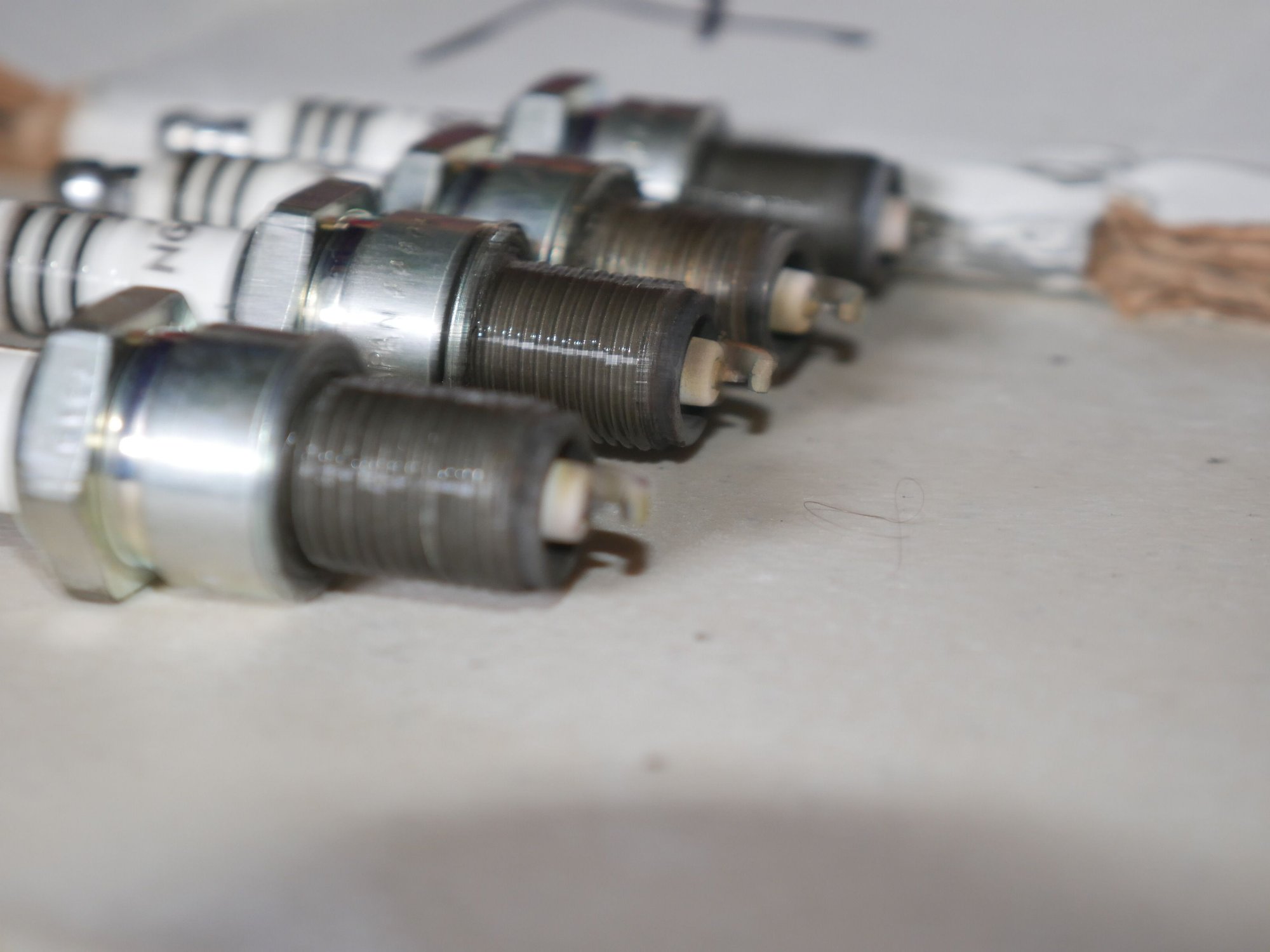

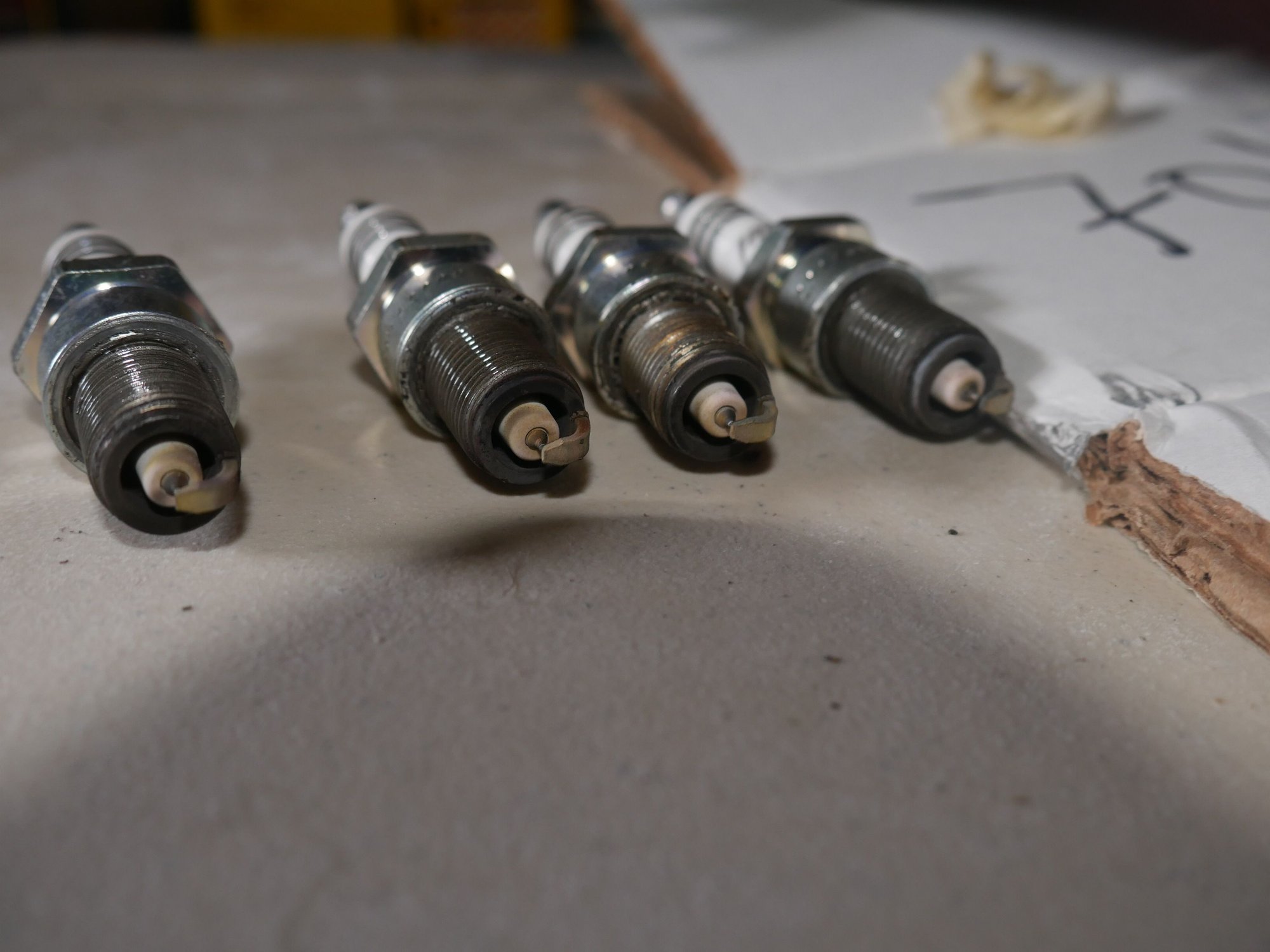

So I finally got the chance to pull the spark plugs out and here they are. They look worn, but still not sure if this was causing the problems.. What do to you guys think?

Need a better photo from a different angle.
To me it looks like 3 of them have the threads wet with oil but it might be just the angle?
Plugs themselves don't really cause problems, they're just an indicator of what else is broken.
Cause and effect.
Oil on the threads usually means broken ring lands because it's been knocking with too much boost.
But you don't want to know that.

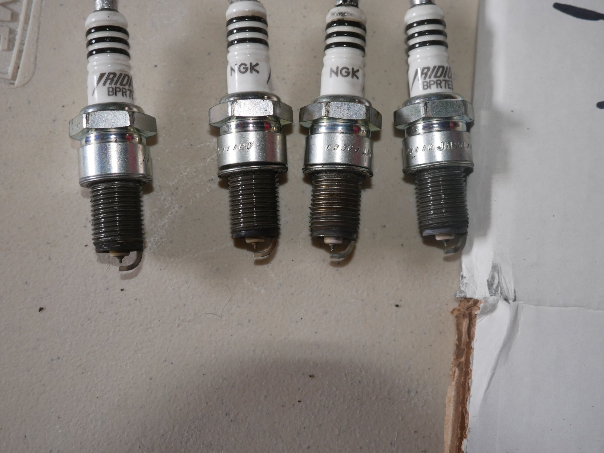

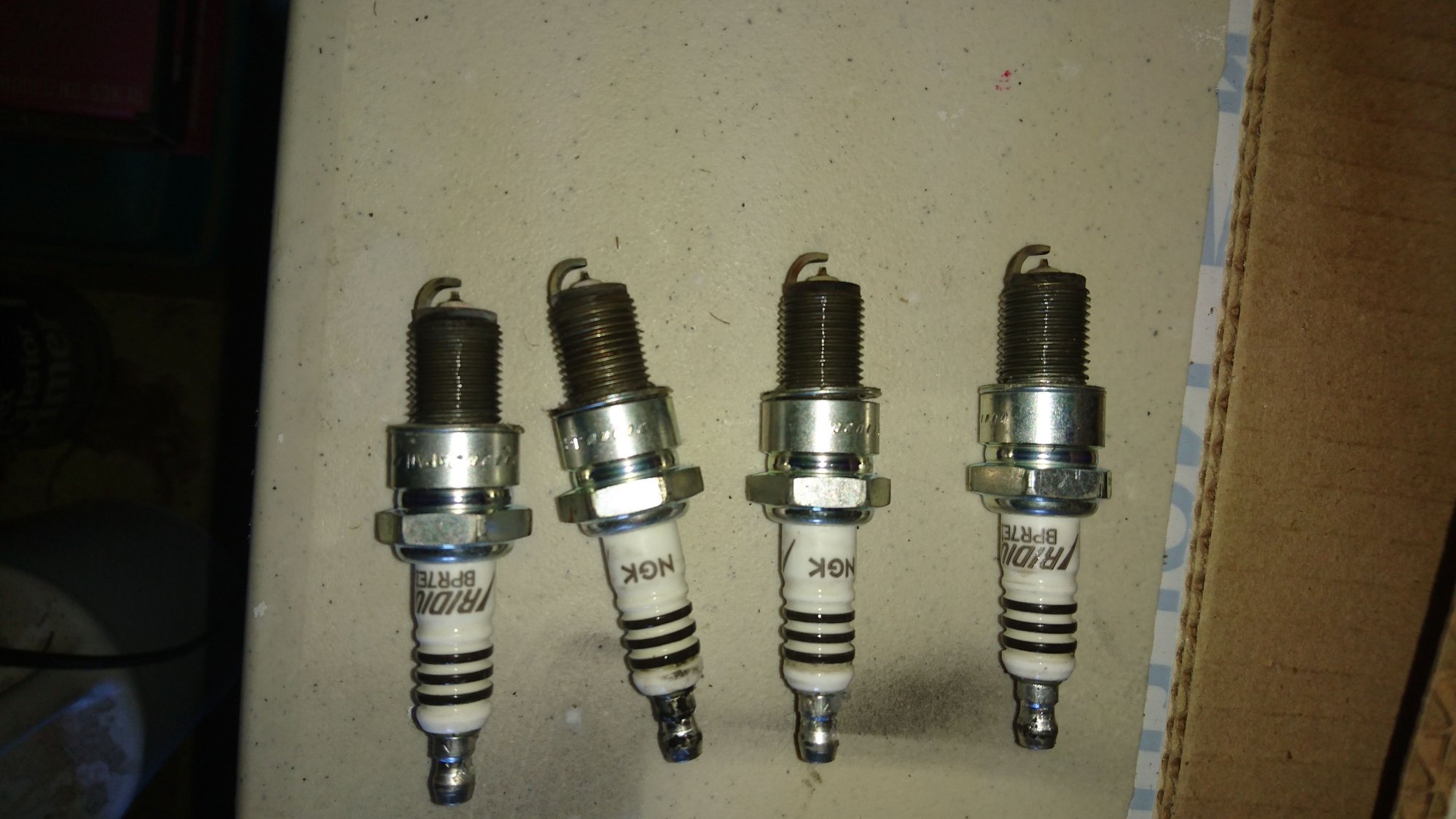

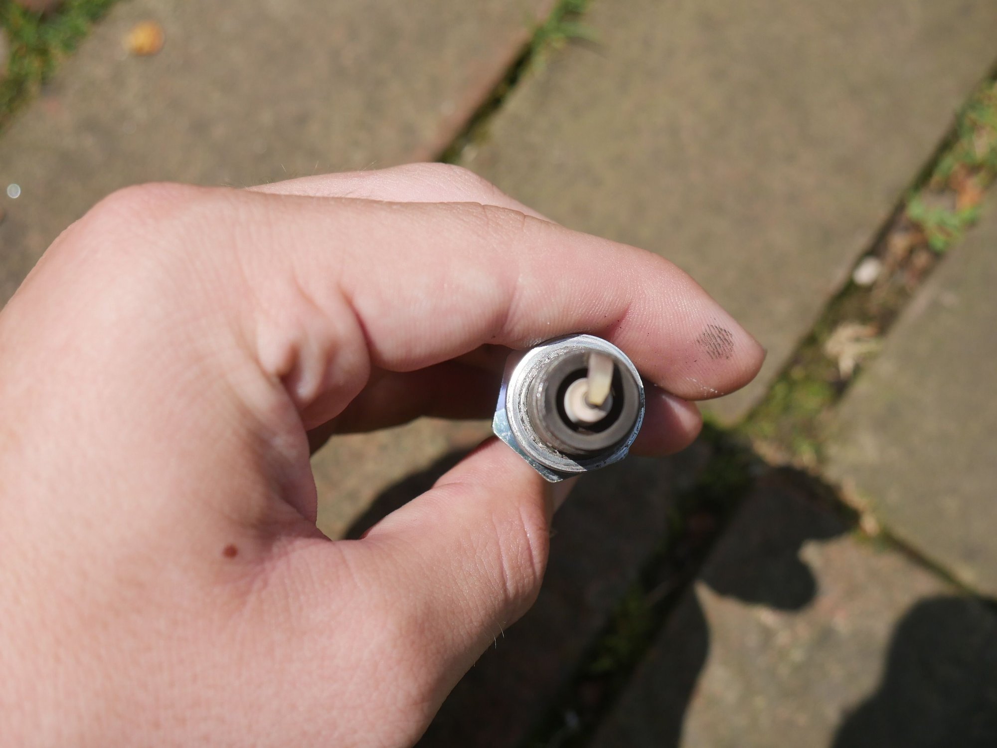

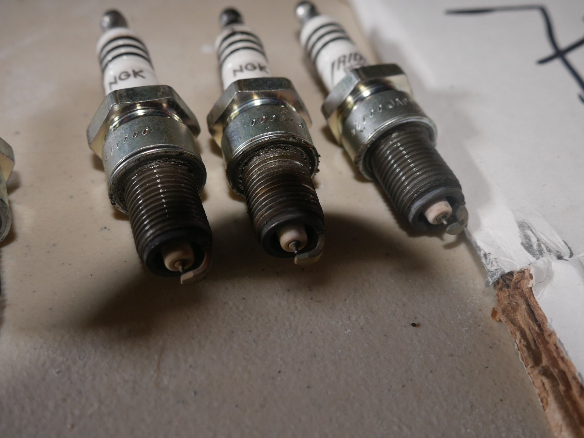

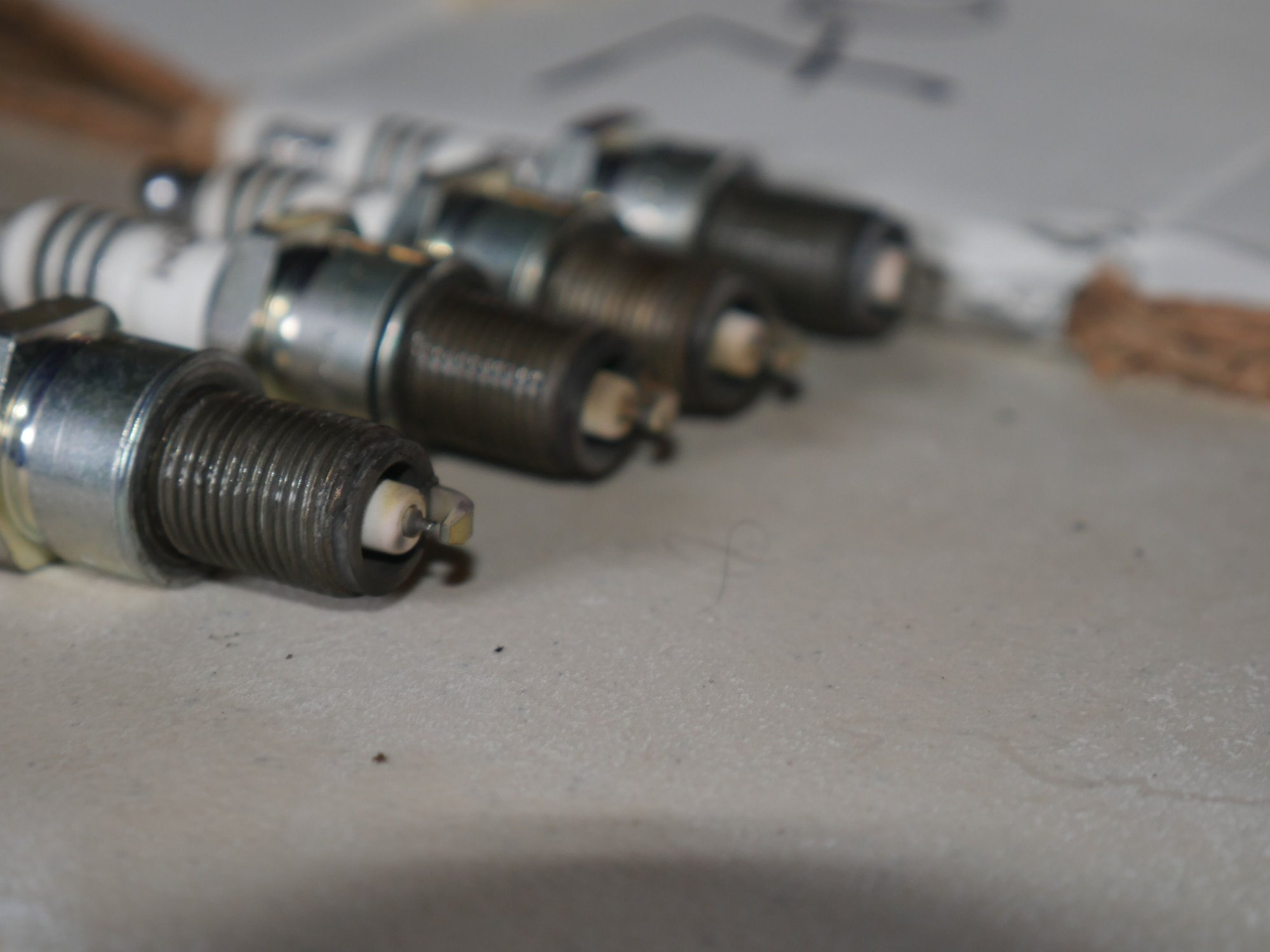

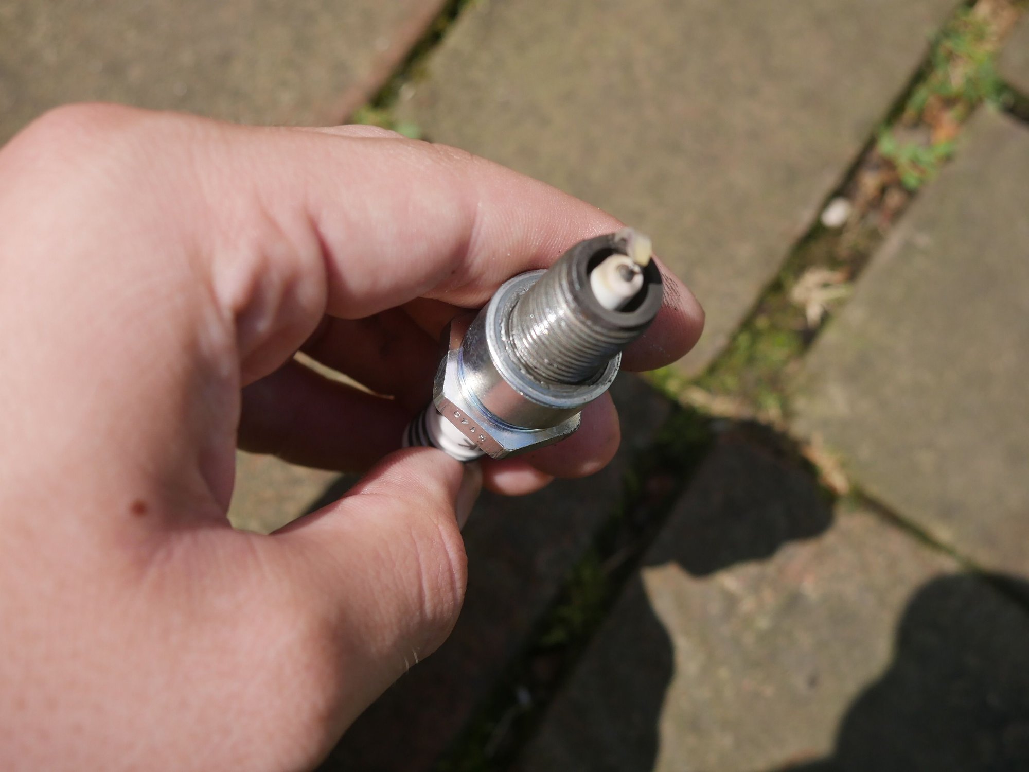

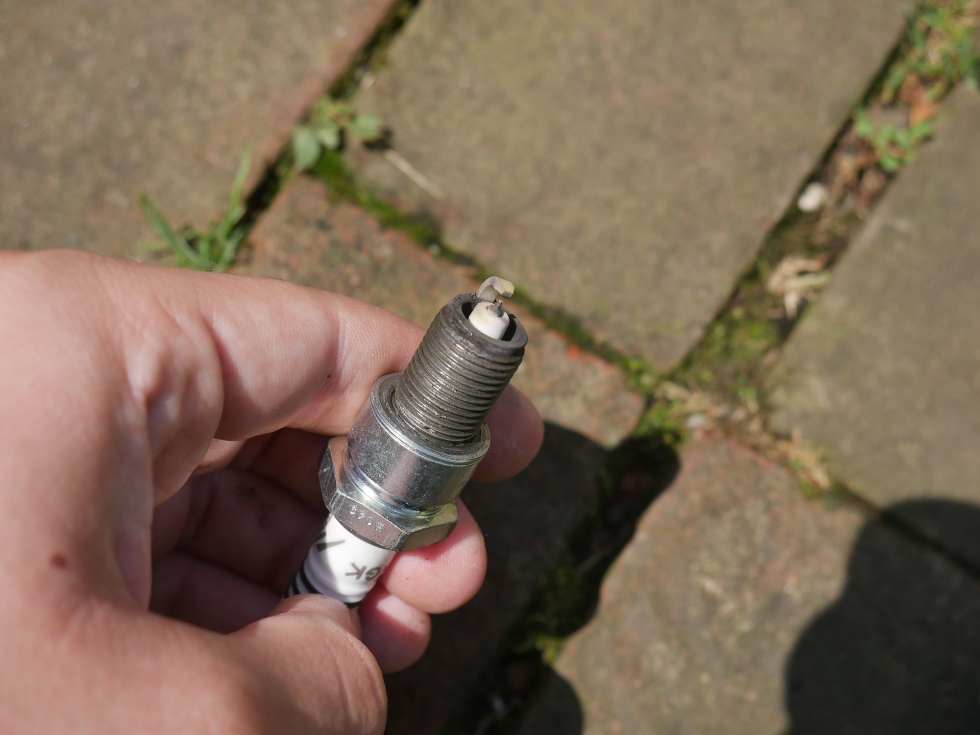

Here are some better pics..
The thing is that there was no blue smoke or any smoke indicating worn piston rings.

Plugs look fine. I run coppers bpr8es they are 2.49 each. Cant go wrong.
Have you swapped your map sensor? Are you on speed density?
