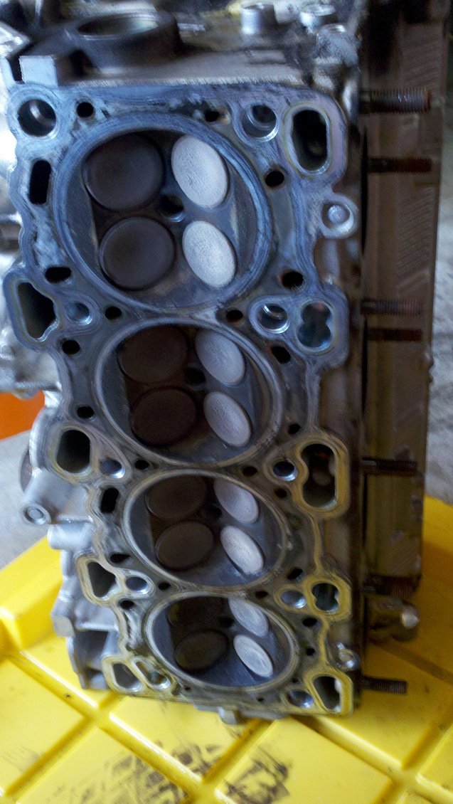

i never comp tested my engine after the failure, but here is a picture of my head with 3 bent valves. The picture kinda sucks but it doesn't seem like the valves aren't seating and the car ran fine aside from the noise.
Could you describe the noise it made?
its been a long time, but I remember thinking it was a stuck lifter, even ran through the factory procedure for that issue before checking the timing belt. Also kinda suspected maybe an exhaust leak.

allow me to clarify my statement. I never corrected my timing and tried to run the motor. So the noise I was hearing was likely the sound of the valves actually smacking into the pistons. I have no way of knowing since i never re-timed the motor and tried to spin it. I just kinda knew as soon as I saw the timing off that the noise was probably Piston-to-valve contact and I was going to need to pull the head. Turns out that I was correct in that assumption, because 3 bent valves. Kinda strange that only 3 bent you would think it would have been at least 4 but weird **** happens.
