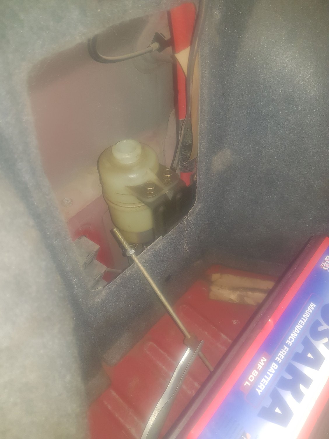

In a JDM evo 8 do you fill the ACD fluid from the container in the back? Look at the pic .
secondly are the ACD/AYC fluids the same? The mistsubishi atf sp3?

Yes they use the same fluid. And, correct you fill the fluid wherever your reservoir is which in your case is in the trunk. However, the bleed nipple is not located in the trunk but rather on the transfercase and Id guess on the rear diff for your AYC.
