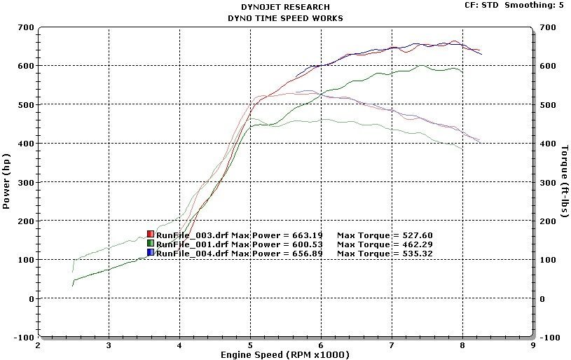

I took the car out today because it was somewhat cooler and wanted to do a fresh pass like I normally do to see how the VD results compare vs what I posted in my S362 thread. Below is the pass today vs the pass I provided in my other thread just before my dyno session. The car is making about +30hp and lag is ~400rpm. I definitely feel it is faster, but I am also running more boost, no CAT, open dumps and 1deg more timing. I'll make an appt tomorrow for the dyno and we will see what it says.

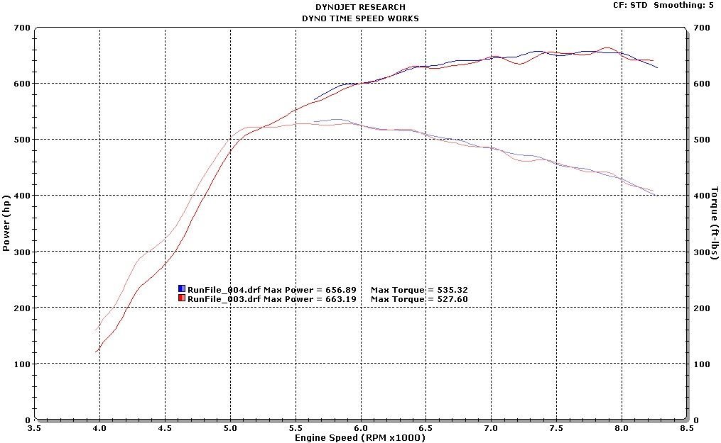

663/527

Originally Posted by 240Z TwinTurbo
663/527
Worth it or swapping it out?
it is a keeper

I will make a more detailed write up in the dyno section, but results below on Shell 93 pump gas.
The green line shows the previous results with the S362 SX-E
