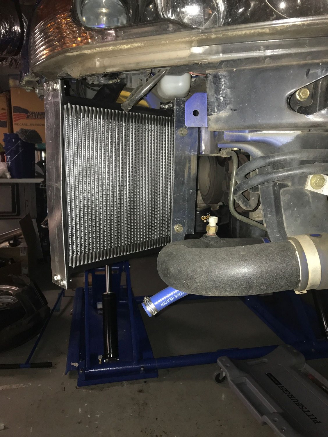

The new oil cooler arrived last week, but I just got around to mocking it up so I can order the fittings. The oil cooler is much larger than the stock unit so it makes getting it in there somewhat of a challenge, but I think I have it figured out. While I had the car on the lift I replaced the oil pressure spring that had been shaved down for my 2L by ~0.125" to get the pressure down to a reasonable number. However, on the new 2.15L the pressure was on the lower side of what I wanted so I just replaced the spring with a new factory unit.

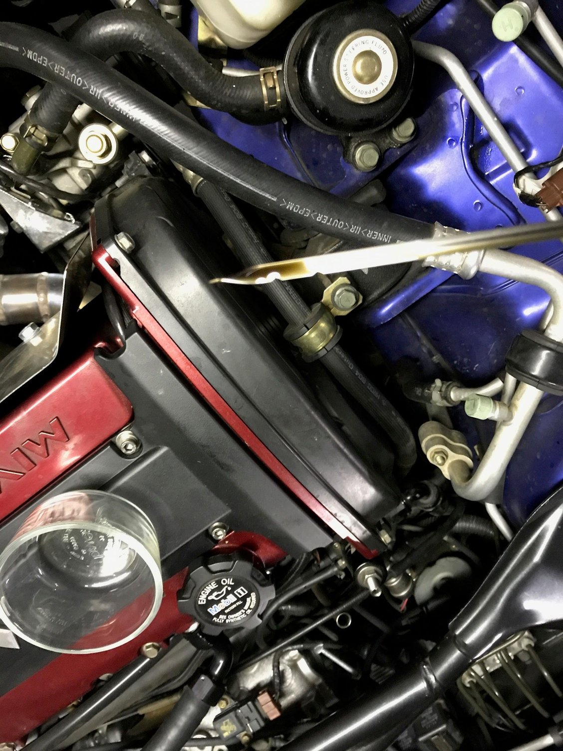

I also checked the new catch can setup for accumulation and it was essentially dry with just a few drops coming out of the cap so that was not expected. Now that I have ~650 miles on the new turbo setup since the oil change I decided to check oil consumption. Keep in mind I have been beating on this thing a lot so I expected a decent amount of oil consumption, but to my surprise very little was gone.

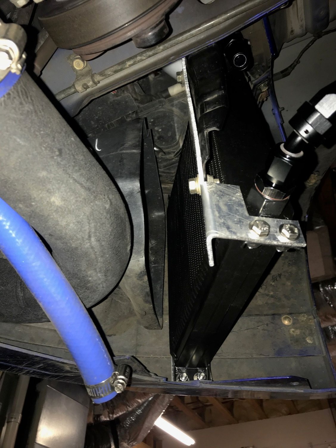

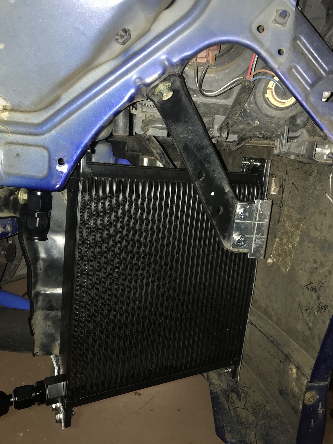

Got the oil cooler mounted and didn't even have to bust out the welder. Just need a vice, hammer, drill, jigsaw, and propane torch.

Always nice to see a big cooler in the proper orientation. I see way too many upside down coolers and cheapo replacements on these cars.

Thanks for the kind words. I don't race the car so I probably could have gotten away with the slightly smaller (height) so it would not need to be angled in order to fit. Regardless, it does fit at an angle so I am happy with the results. The cooler has something like a ~0.75qt capacity so as soon as I pulled out of the driveway and drove 100ft I saw the pressure drop from ~80psi to ~35psi for 1-2 seconds and then quickly rebound, which was the pump filling the empty oil cooler. I guess this answers my question regarding flow through the cooler prior to the oil temperature reaching the thermostat set point.
